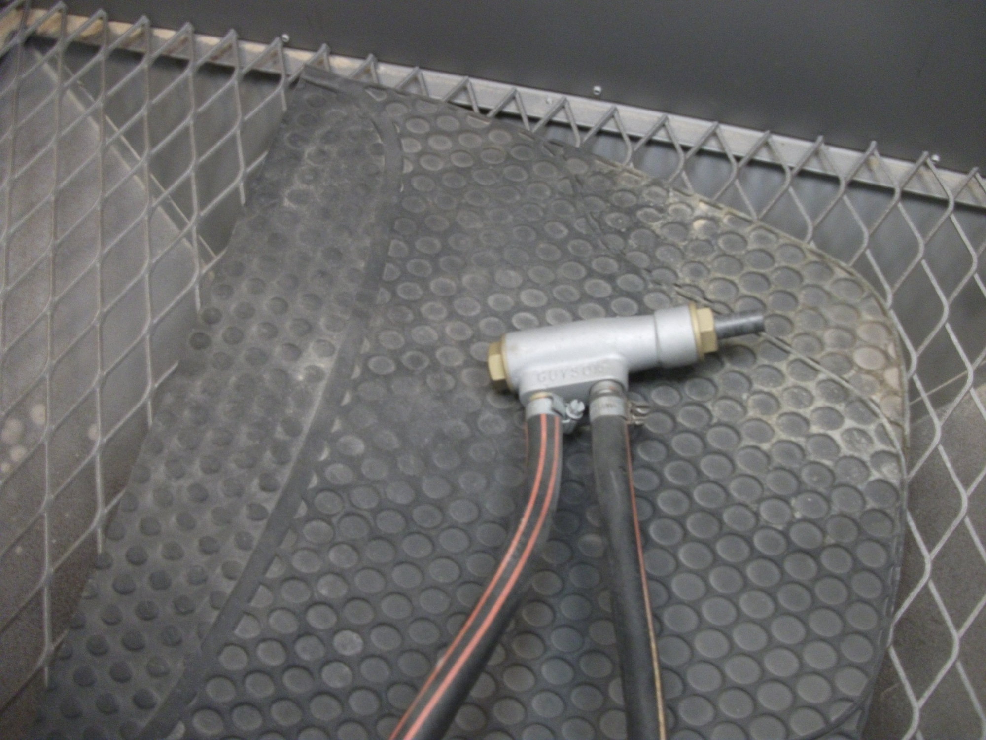

Ok my cabinet is now sorted finally Sonu need some media I was thinking of using glass bead of some sort but what size anyone got any suggestions
Thanks Tom
Thanks Tom
glass beads are for cleaning and peening the surface without damage . crushed glass is for blasting getting rid of rust and leaving a good surface key for painting ,size depends on what size nozzle your running and if its a suction gun or pressurised potOk my cabinet is now sorted finally Sonu need some media I was thinking of using glass bead of some sort but what size anyone got any suggestions
Thanks Tom
Bicarbonate of Soda ?
It is available in various grades depending on how much cleaning action you need.
Excess can be washed off, and it can also be used in solution to passivate items cleaned in an acid bath.
. Anyone that has done this before will understand.
I will point out its not supposed to be used as it contains silica. my cabinets well sealed and the 4inch woodchip fan can pull more air out than a pressure pot can put in I also wear a mask just in caseIf using sand you should ensure adequate through draught into a proper filter - shouldn't you? It is very harmful to your lungs. I stopped using it years ago because of the dust.
