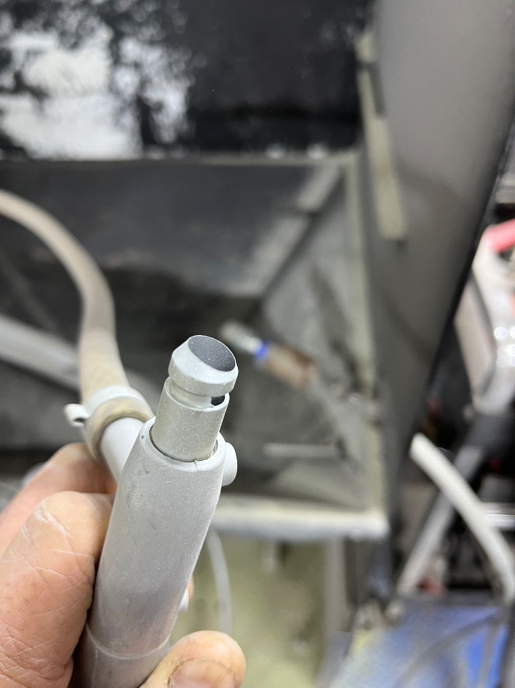

Will do that nowHave you searched for media blasting nozzles rather than tips?
Couldn’t find em on eBay,only ceramic ones,but ain’t sure if they are the sameMachine mart sells them plus ebay
Yours looks like the steel one that comes with the gun.Couldn’t find em on eBay,only ceramic ones,but ain’t sure if they are the same
Yeah the jet is a bit worn but I have a spare one.do you know if these ceramic pink ones are the same size?Yours looks like the steel one that comes with the gun.
Ceramic is much better.
Make sure you check the air jet as well, will wear on one side where the sand comes in.
I don't see a pix, you'll need to measure your old one, and compare.Yeah the jet is a bit worn but I have a spare one.do you know if these ceramic pink ones are the same size?
