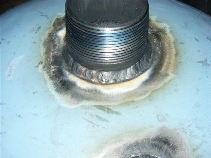

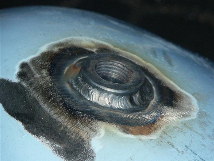

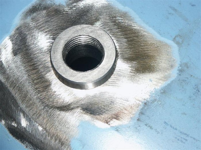

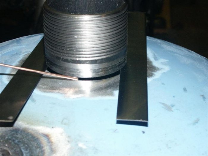

A little up date on this project. Built and finished not long after this thread started in April 09. I used a standard brass gate valve for the bottom media, I adjusted it a bit at first, but once I found the sweat spot I've left it alone. The rest was, black iron fittings all welded.
I'm a bit of a skiprat, finding a load of Air conditioning hose, I used this for the outlet pipe, with a PCL Fitting for the nossle. I've worn a few PLC fittings. The pipe has only worn out in the first 12" from the tank, and that was likely because of a fairly tight bend.
I have been running it off a Clarke SE19/150 compressor, however it really does give it a hard time running constantly with pot pressure set at 60psi. I've a 48CFM Hydravane I'm going to rebuild, so that'll be a problem no longer.
I've a picture of the finished thing I'll post up once I find it.
