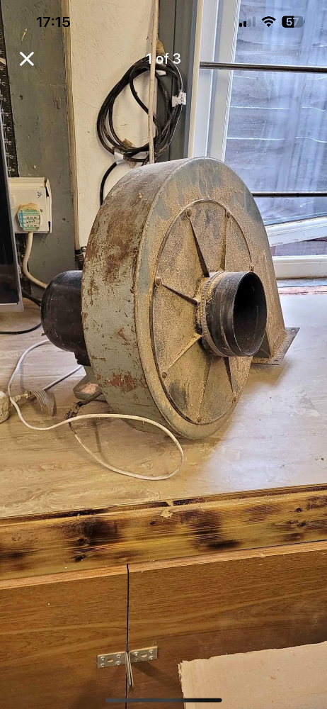

It’s actually a home made one from a drinks machinewhat size cabinet have you , mine will take a car wheel and tire and use a woodchip exracta
for scale, how big is the hose inlet ?This worth buying folks
£20also will it work for paint extraction?be about a 4 inch duct. will work perfectly if its cheap enough![]()
in a cabinet it will , wont be any good just in a room though£20also will it work for paint extraction?
What if I made some kind of large scoop for it?in a cabinet it will , wont be any good just in a room though
To surround the paint gun ?What if I made some kind of large scoop for it?

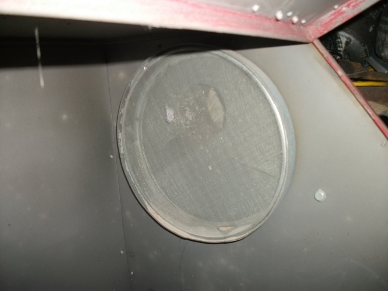

That hose (if it's like ours) is very thin (doesn't hold up well) and makesJust wondering if I could use tumble dryer hose with this for the cabinet,or will it collapse?
yep thats all i use on mine from the cabinet to the fan then from fan to just outside just a bit of sweeping up to do hardly any as i have a fine filter in the cabinet up on the side so only loose the dust it has a mesh floor with a rubber mat covering most of it so spent grit just drops down in the hopper and the blast jet doesnt blow it all up and around the cabinetJust wondering if I could use tumble dryer hose with this for the cabinet,or will it collapse?
