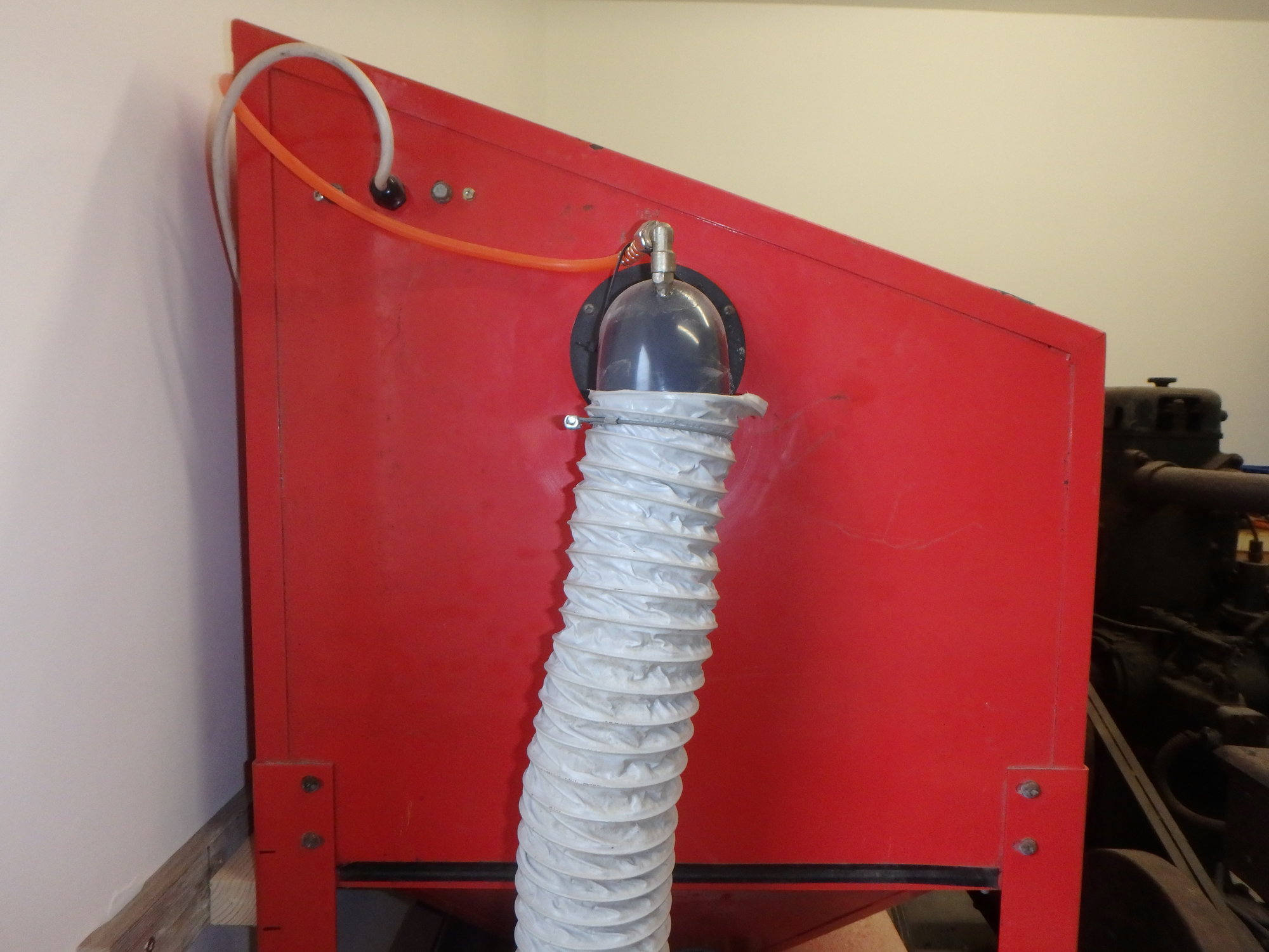

Seems to work well enough. It's not the final evolution, I'll be putting the smooth tube on the elbow and the flexi out of the door, this will give slightly more suction. 1/4" supply from a barely cracked open 1/4 turn valve at 90 psi though a 75mm long tube from an old blowgun.
