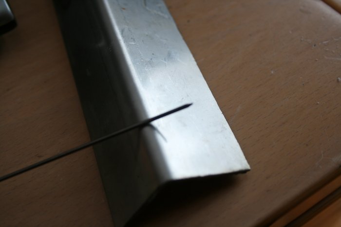

Sounds like a gas problem to me, seen it before with red tungstens when I was using old shi%%ers with bodged hoses. Maybe check all hose connections, if you havent already.No leaks anywhereThe local comedian hadn't been in and swapped your tungstens for sharpened stainless filler wire with the ends painted, had he?Sounds like a gas problem to me, seen it before with red tungstens when I was using old shi%%ers with bodged hoses. Maybe check all hose connections, if you havent already.
Have you got the post weld gas flow turned on
Argon?![]()
I AM using ARGON.
I saw a thread on weldingweb where someone used agroshield. I just sorted the problem, the o-ring on the backcap was split. I replaced it and now perfect welds again.
