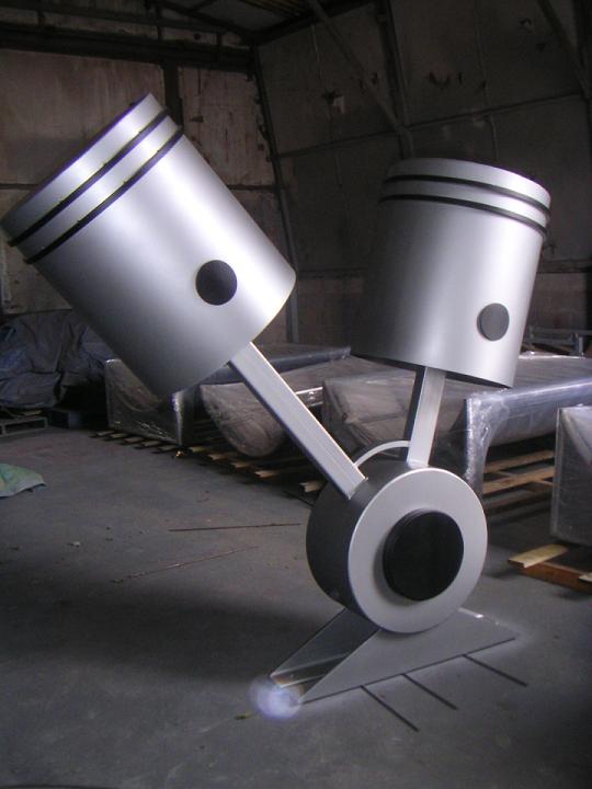

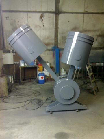

A sculpture, for a gagrage forcourt.
customer gave us rough design/sizes.
All out of 4mm plate, rolled and welded, then capped.
Outside corner joints on sheared edges
100x60 box for the con rods, 200x100x12 rsa for the base.
Gudgeon pin ends 120mm x10mm discs, formed to fit the rad of the barrels.
Rings from 20x12 flat.
The 50x20 flat link between the two con rods was added afted to stiffen it up a bit, doesn't look out of place.
Just in primer paint at the moment, 2k epoxy grey.
