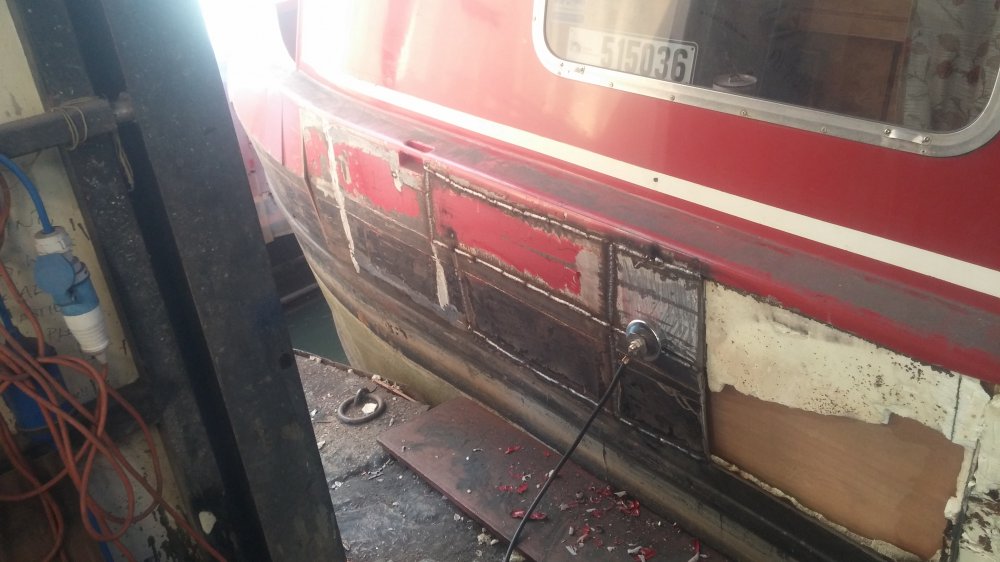

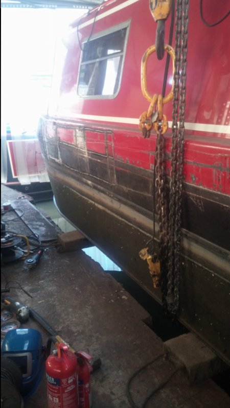

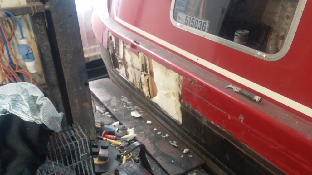

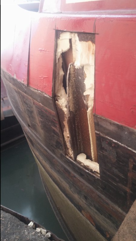

Just thought I would post a few details and pictures of my current job I'm working on.
I was asked to reduce the width of this boat at the front. As at the rear the boat measured 6"10 which is standard but at the front it was 7"1 ! Which ment it was getting stuck in the narrow locks.
I have had to cut off the D-bars then cut the top section of the hull out, trim the knees slightly, straighten the steel and weld back in. By the time both sides are done the boat will be 6"11 which the owner is happy with.
