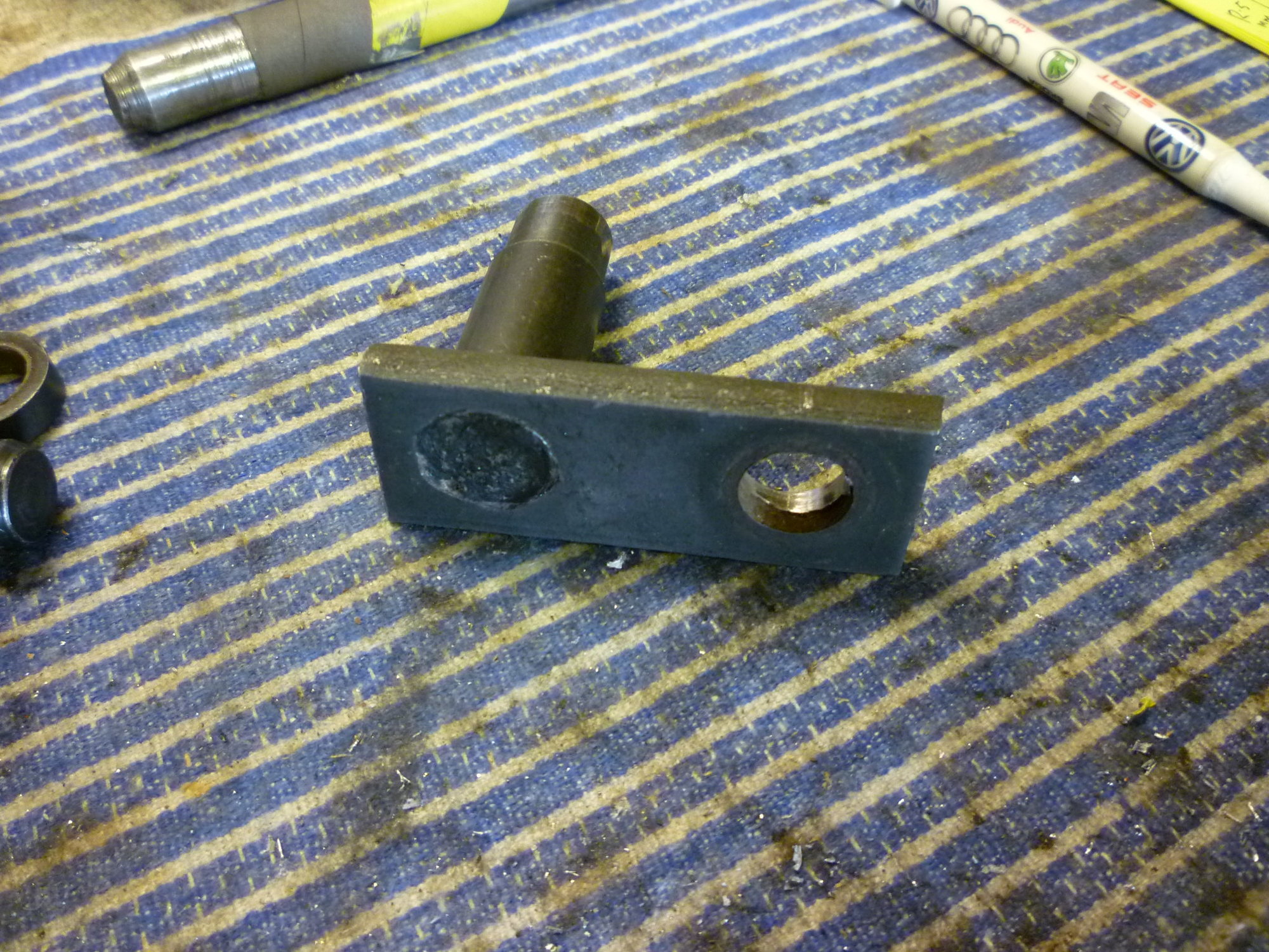

roblane65 Forum Supporter Messages 2,436 Location Newcastle UK Jul 28, 2020 #1 Ok need a new pivot pin machined for my pillar drill anyone in or around Newcastle or further afieldif prepared to post beer tokens waiting to go in the arm the idler pulley sits on anyone ?

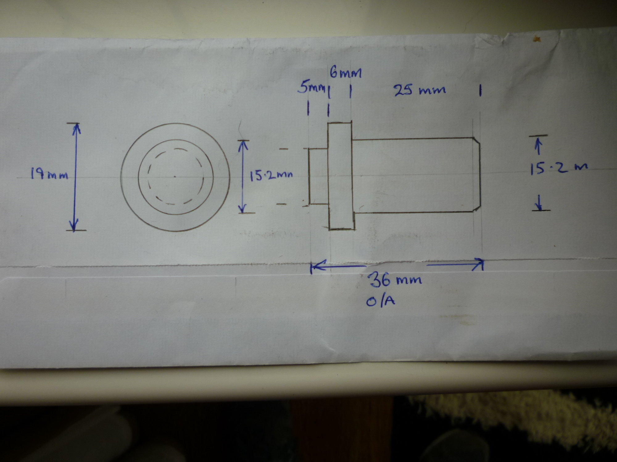

V voipio Member Messages 4,020 Location Not Cambridge Jul 29, 2020 #5 The diameter of the small stub is not given in the drawing.
roblane65 Forum Supporter Messages 2,436 Location Newcastle UK Jul 29, 2020 #6 Well spotted sir it's 12.3mm
