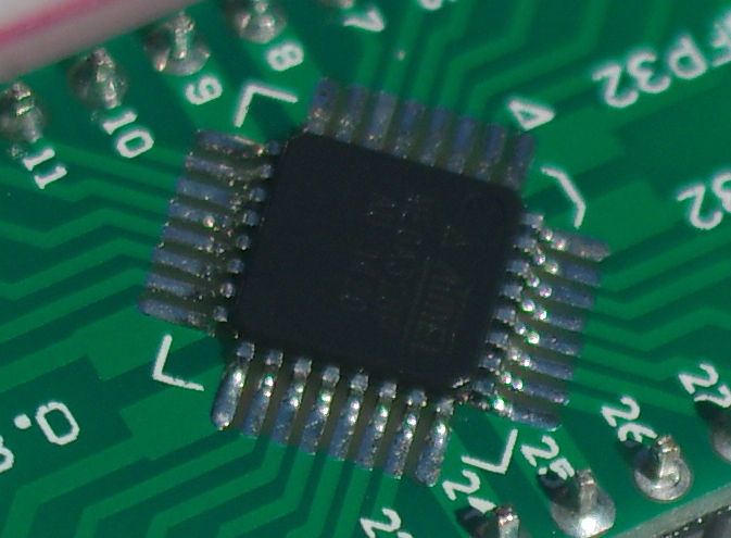

Last time I tried my honkkong phuey hot air gun was to remove an ic, I burnt the board and still couldn't get the little blighter to move.
I have some very old solder paste , it has the constancy of salami. I added flux to a bit of paste so it was about as smooth as non crunchy peanut butter[I am hungry].
Last time I tried the solder paste, I melted the goo holding it together, the little balls blew all over the place.
The new softer mix works.
