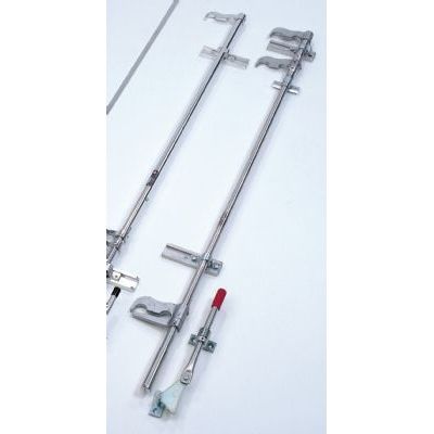

so he bought a stetcher. now he need rails welding in to accommodate the stretcher. he has removed the front passenger seat and the seat behind it and there is plenty of room to fit it and has asked me to design a rail system so it can be slid into place.
pretty basic design. 4 upright pieces of 20x20mm solid square section bar and a length of 20mm round bar welded on top of them. that makes up one rail, then there is a bit of bent flat bar welded on as a way of stopping the stretcher moving side to side.
now the problem. it has to be welded into the floor of the car. the floor is thin. what is the best way to re-inforce the areas around the welds to make sure that in the event of sharp sudden braking, or a collision the welds wont just rip out of the floor?
