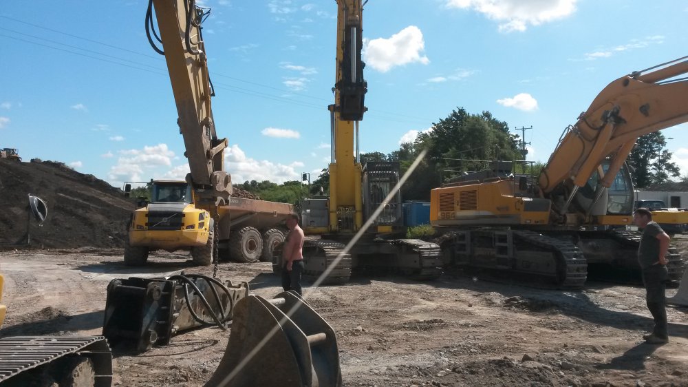

I was asked to get this pecker to fit the machine qr bracket,
