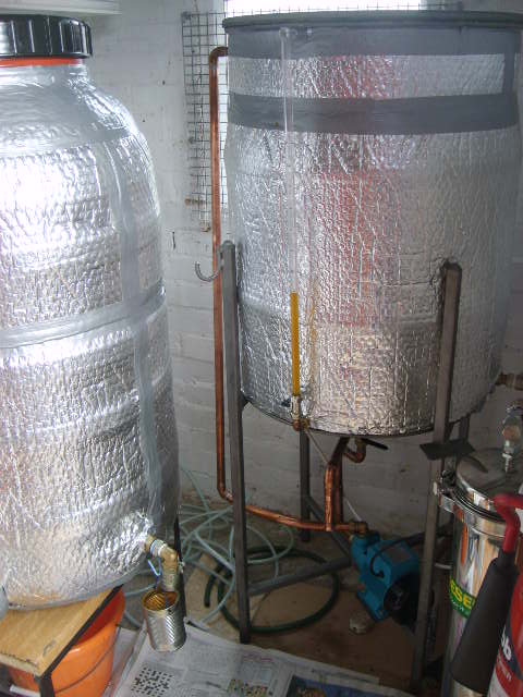

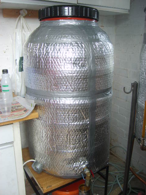

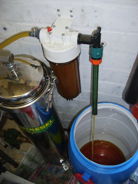

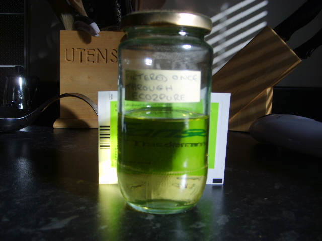

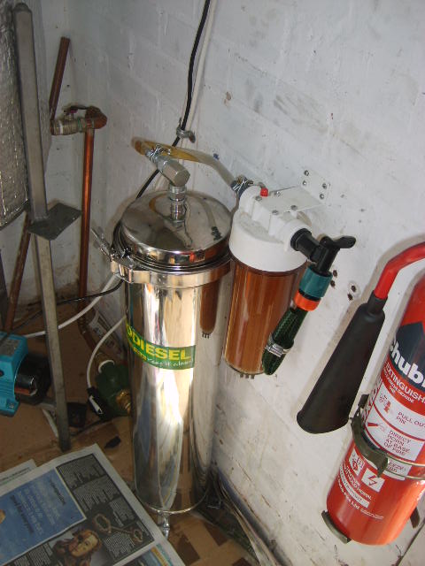

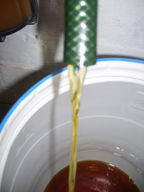

I know its nothing to do with welding but i thought i'd show some pics of my biodiesel set up,first pic is the "settleing tank" this is where the waste oil i collect goes,i filter all the big bits out using a waste paper bin from "staples",the second pic is the "processor" or "reactor",this is where the oil is heated,the chemicals are added,transesterification takes place,the third pic is the "dry wash" tower and final polisher,the polisher or final filter is a 1 micron filter,the next 2 pics is the finished fuel, last pic is of finished biodiesel,the label on the jar says "filtered through eco2pure",eco2pure is a dry wash "media",the tower is full of this stuff,as the crued bio is forced through the eco2pure it removes the final traces of any impurities,fire extinguisher there's just in case.
