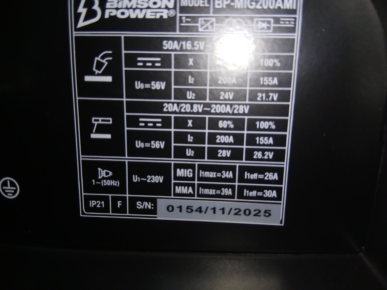

These are currently on sale for £165.99 including delivery. I ordered it after 10pm on Monday, and it arrived today (Wednesday) via Fed Ex.
They look very similar to Rohr and Blackline welders which had a good reputation.

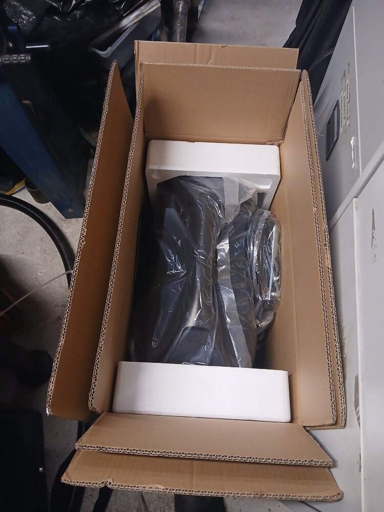

Double boxed and well packed.

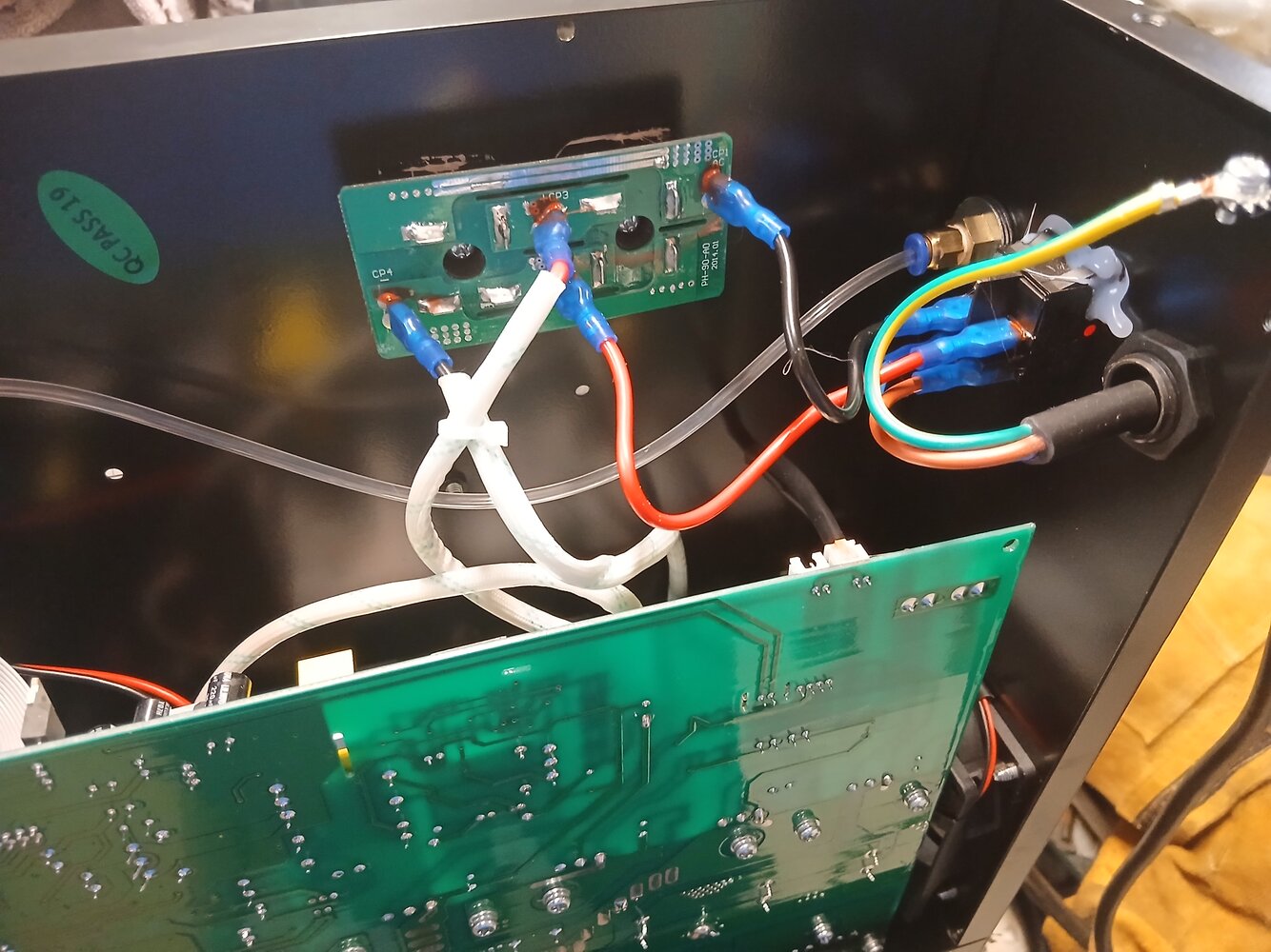

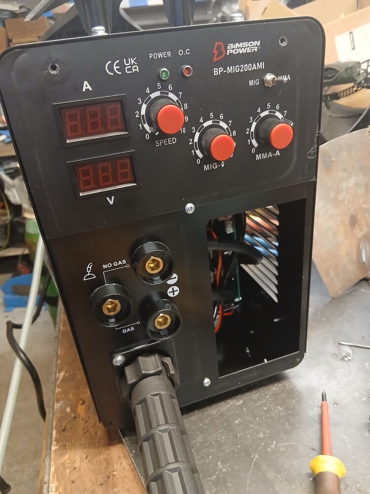

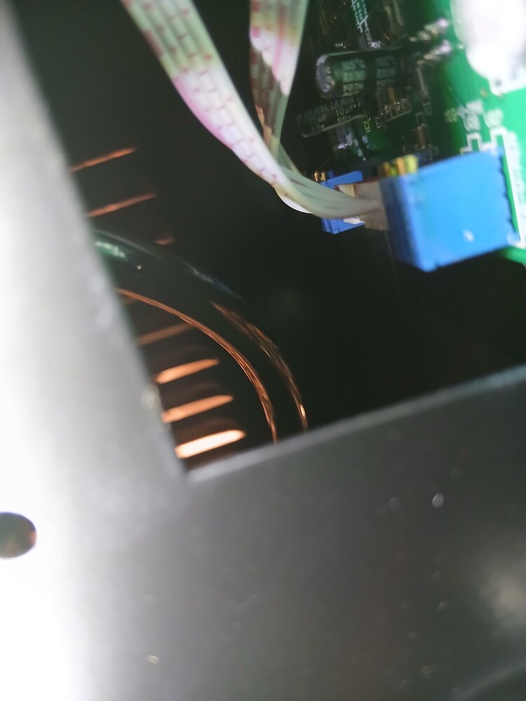

Comes with a three meter euro torch which feels heavy and solid. There's a spring-loaded stinger for arc welding and the return cable is very short.

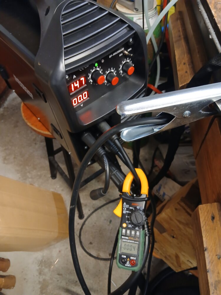

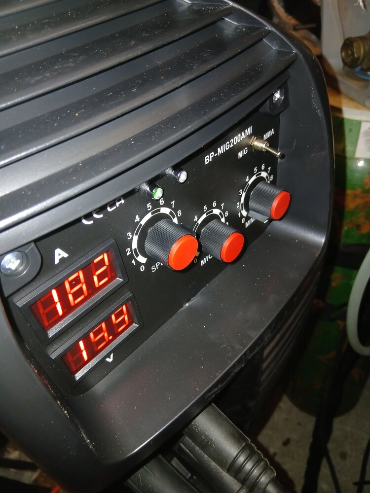

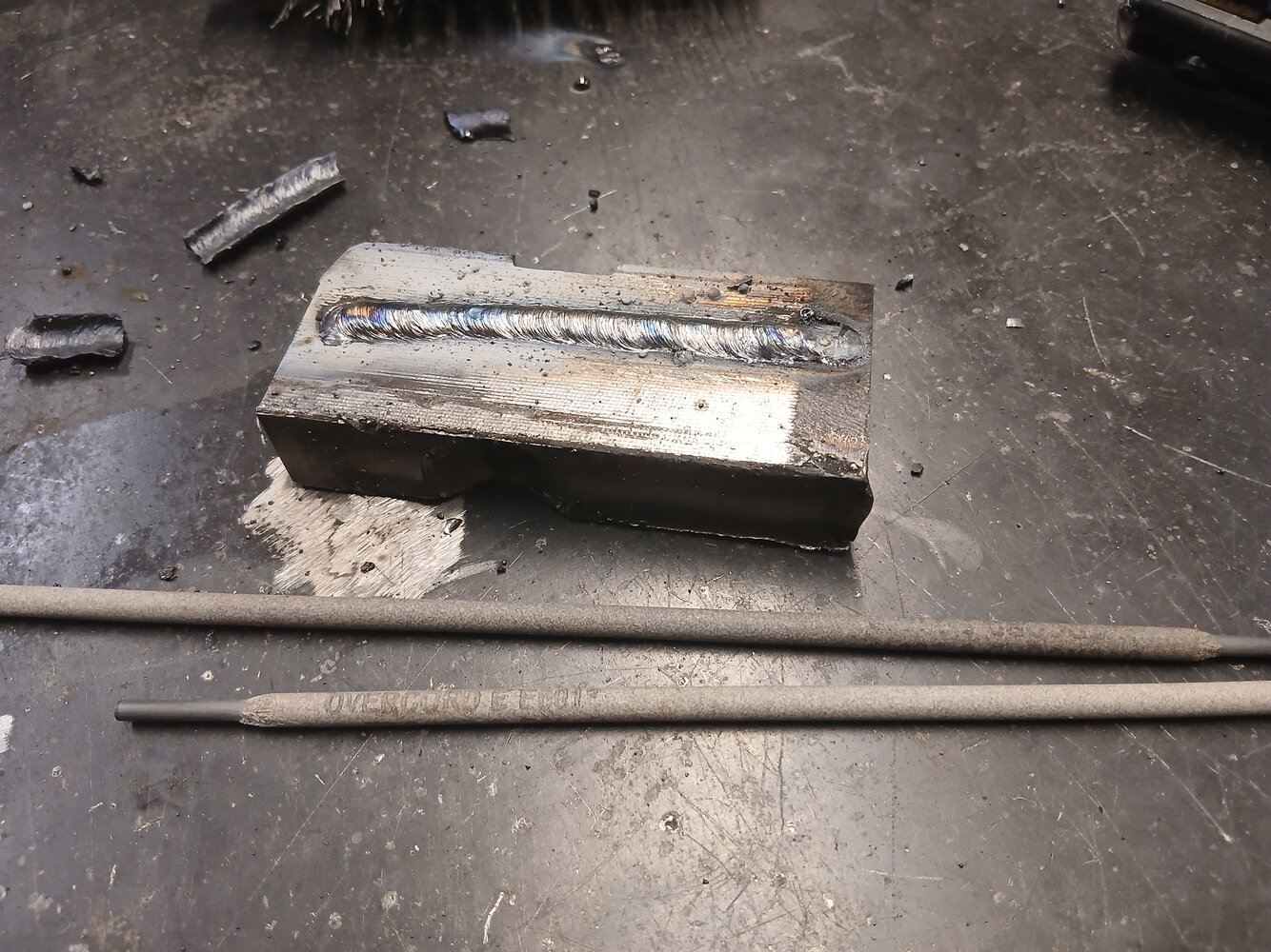

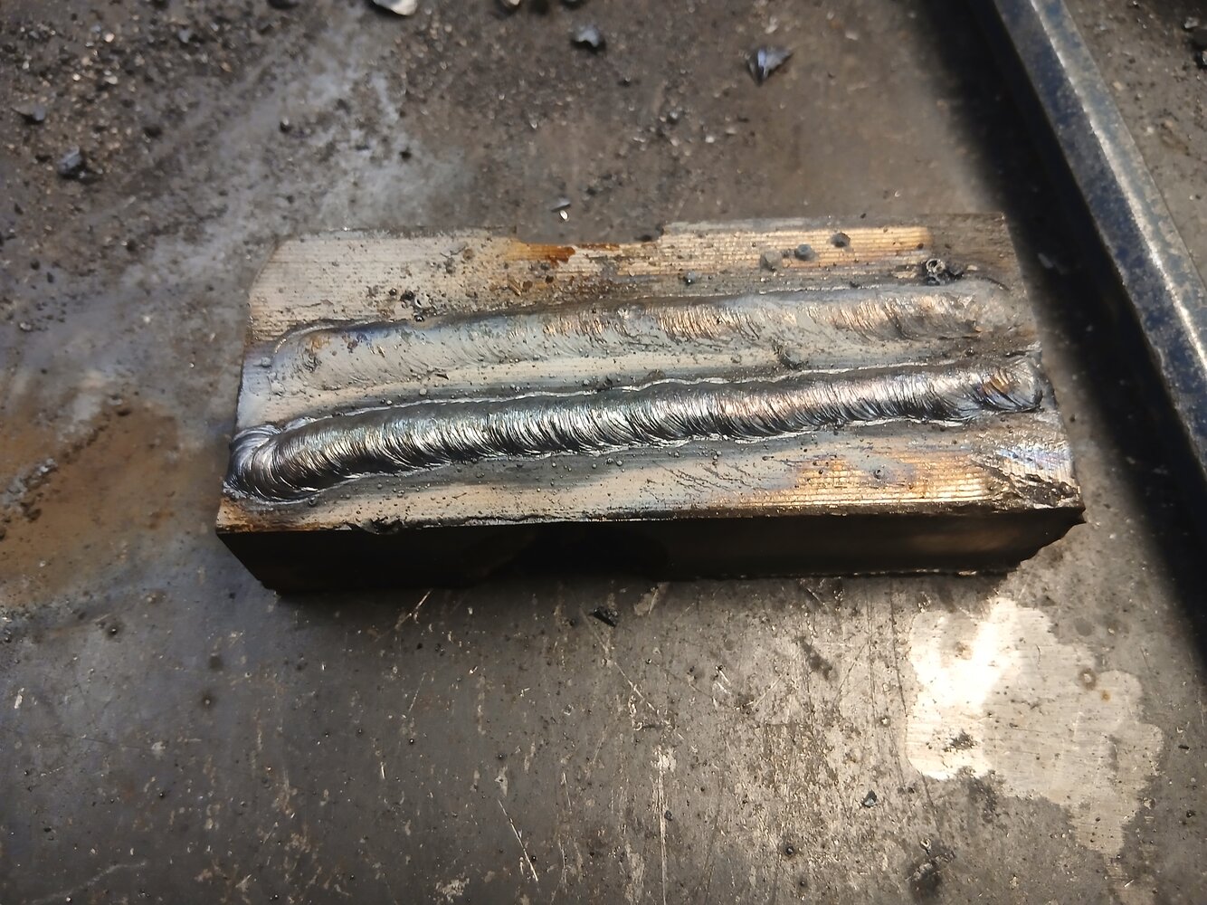

First, a quick go at stick welding. 3.2mm 6013 Overcords. 126 amps on the dial.
Peeler on the first go!

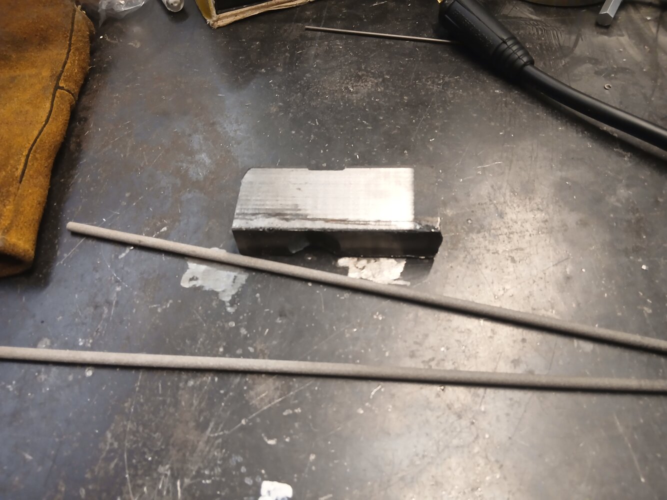

The lump of steel is 20mm thick so the weld is a bit cold.
Not a fluke.
It's doesn't feel like there's any hot start or anti stick. The rods are old though and it hasn't stopped raining for a month so they'll be damp too.

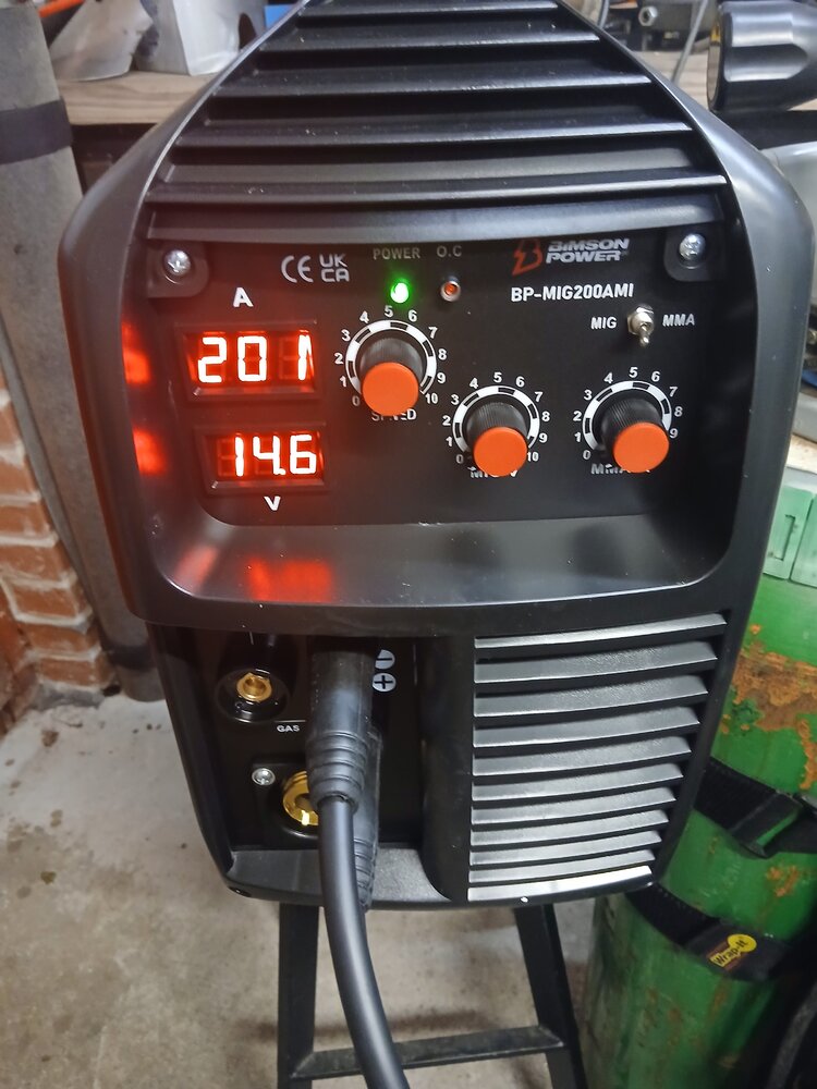

On to MIG next
