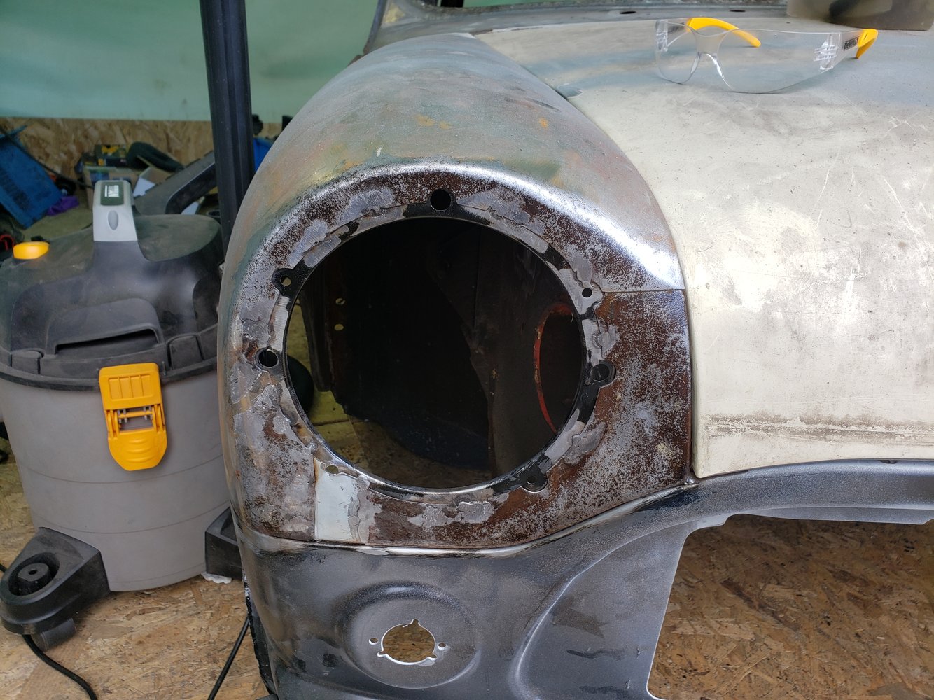

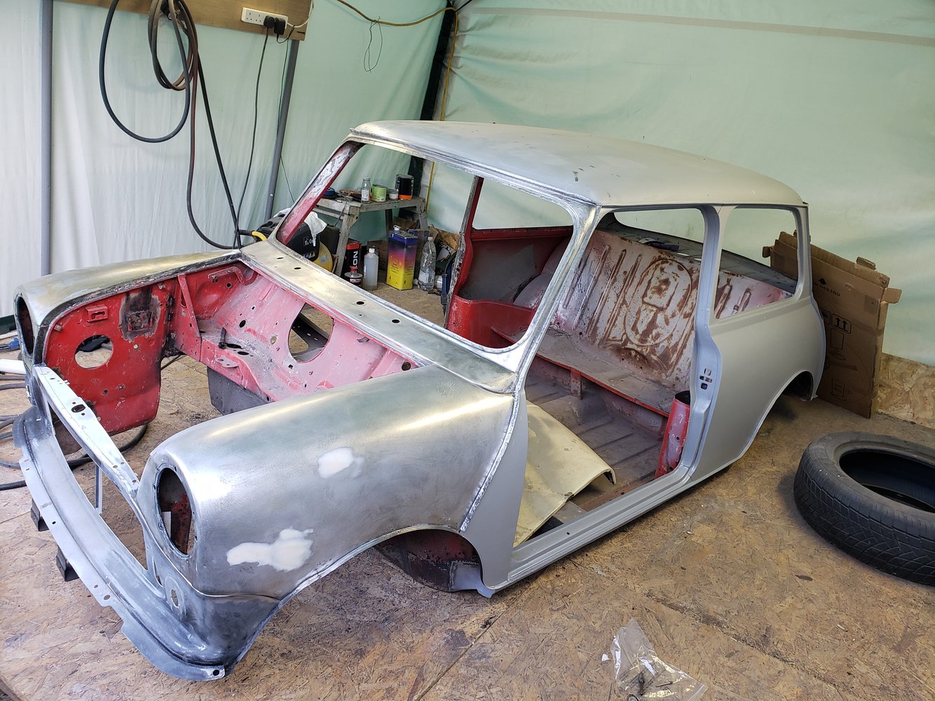

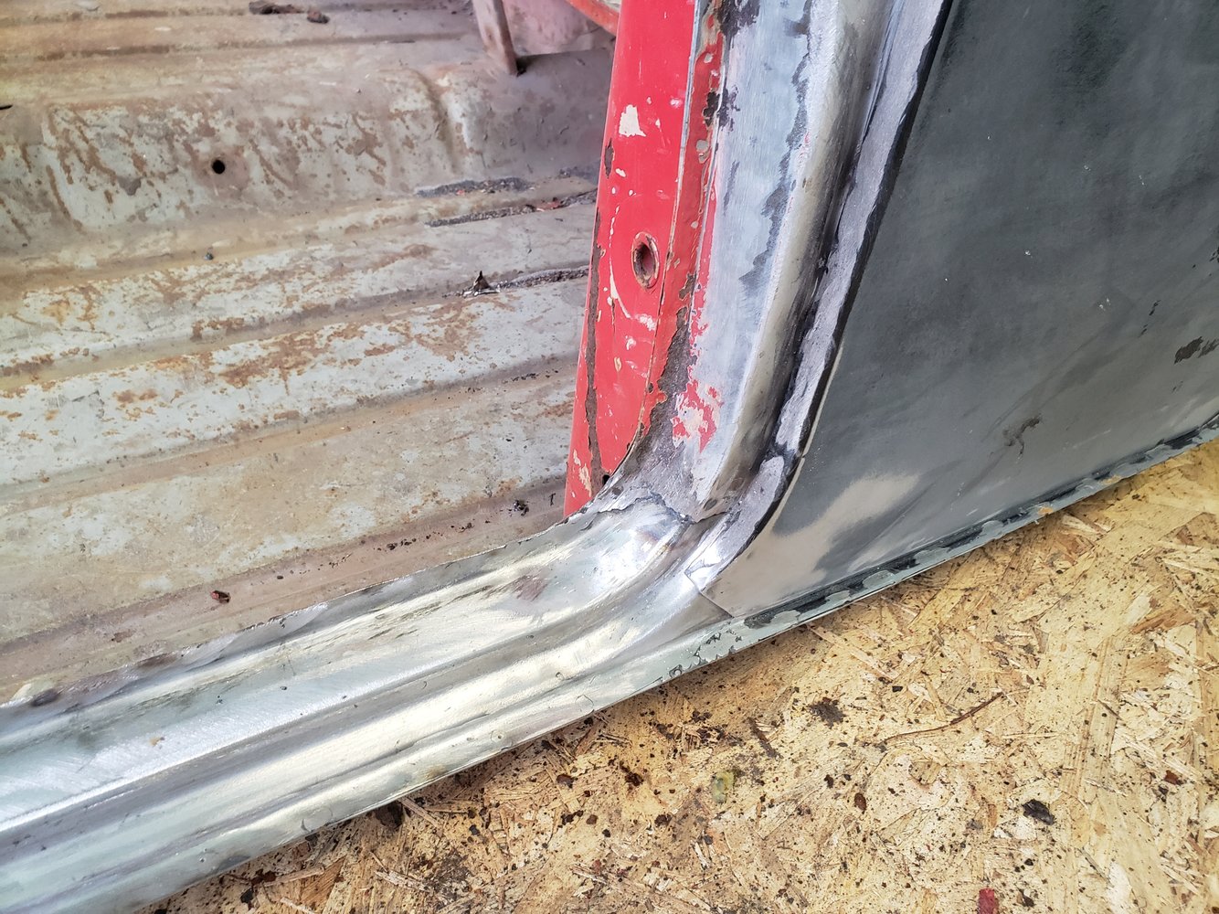

I've been looking at bilt hamber products after seeing quite a few recommendations, what do you guys think? I've got a bare mini shell that is surface rusty. I will remove the rust wherever possible with mechanical and phosphoric acid, but some places I just won't be able to get to.
Hydrate 80 sounds good but I never trust these things!
Electox zinc 1k primer then 2k epoxy mastic to seal it, sounds a lot of effort but if it works its worth it?! I thought epoxy mastic was impossible to sand prior to fillers/2k high build primer?
Am I just getting obsessed with filling/sealing the porous steel from moisture? Should I just 2k etch, prime and paint it?!
