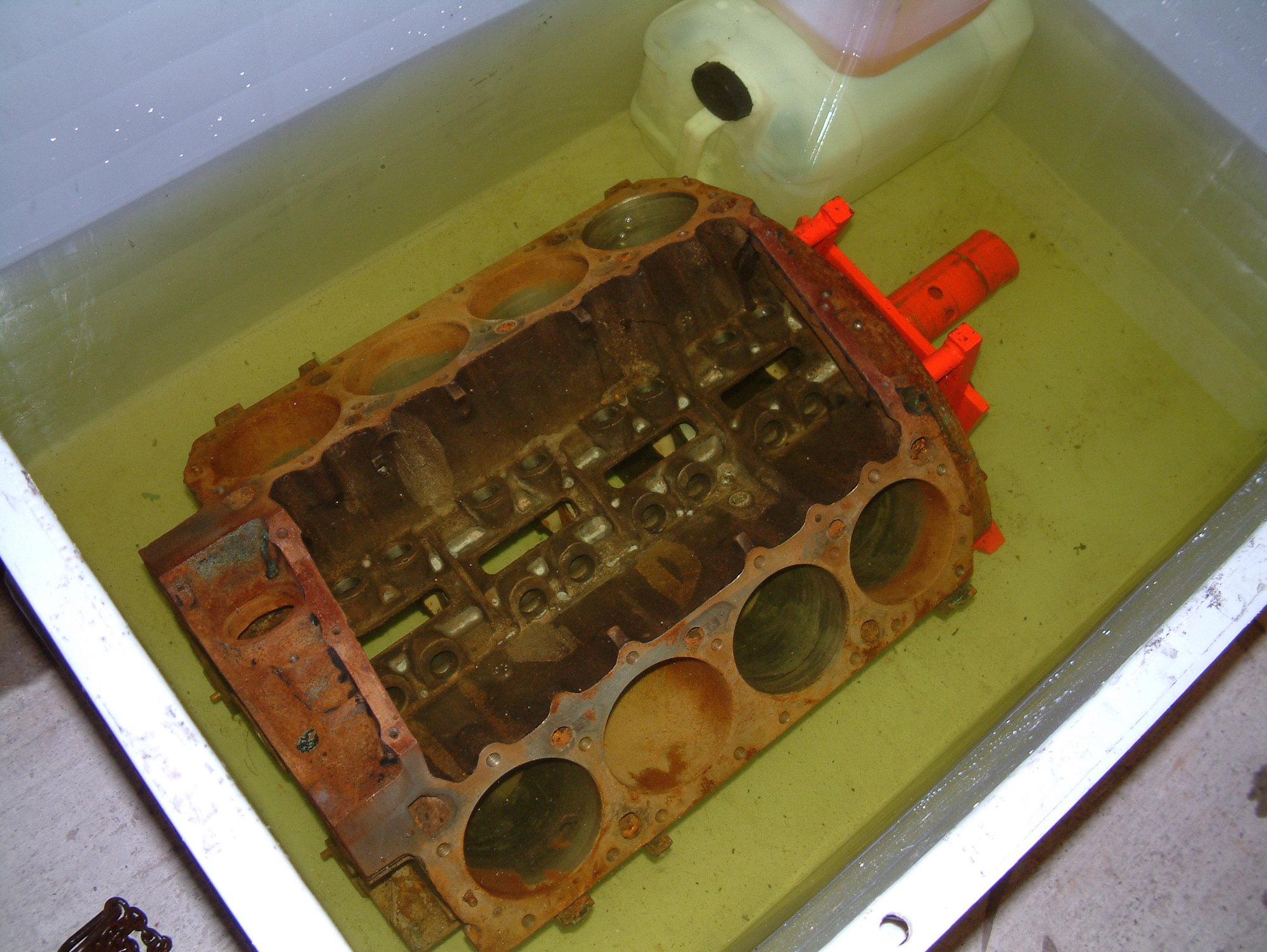

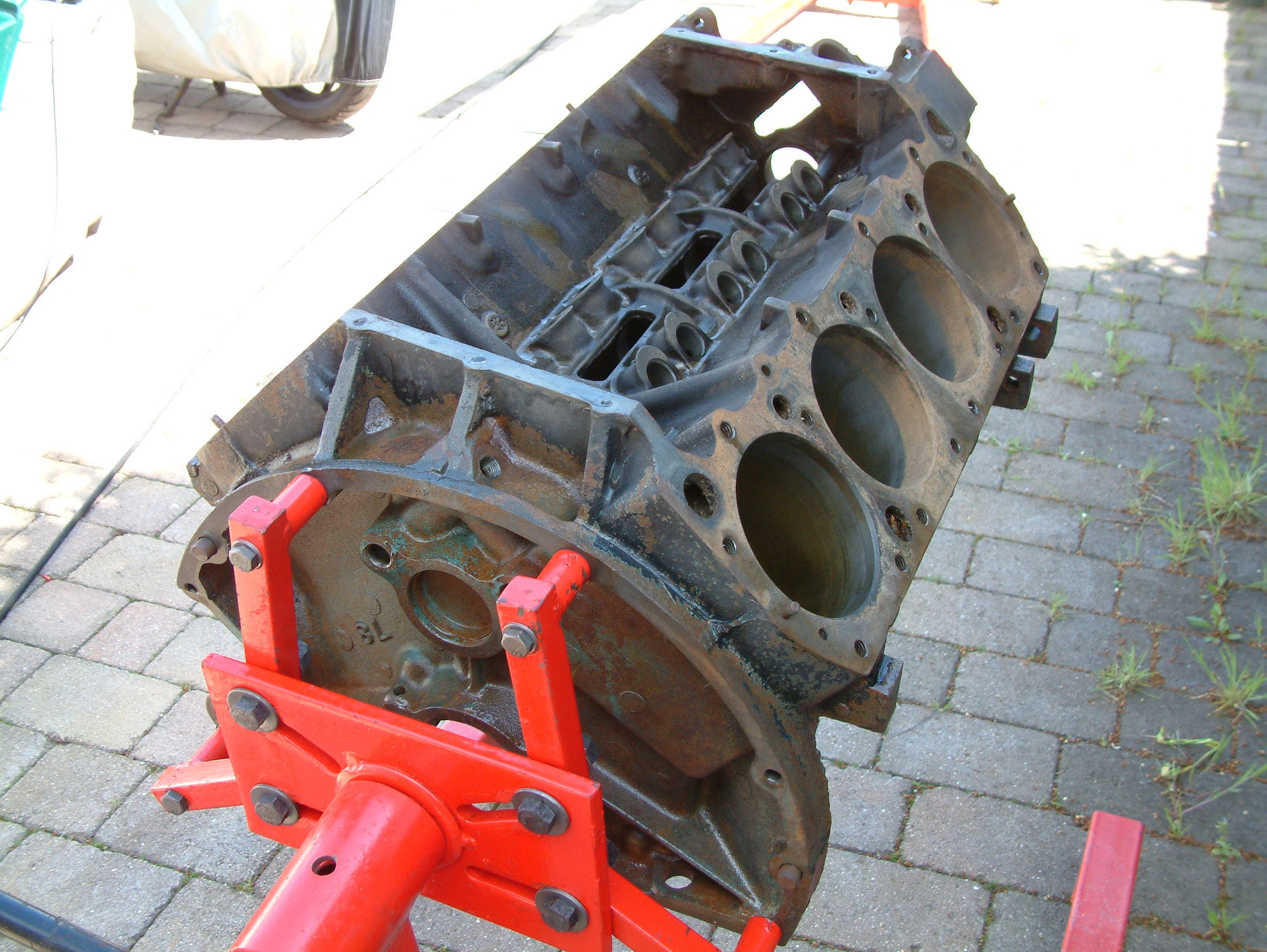

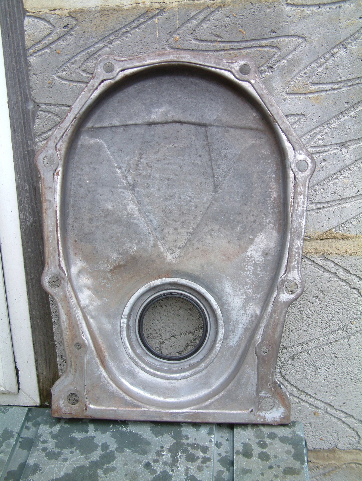

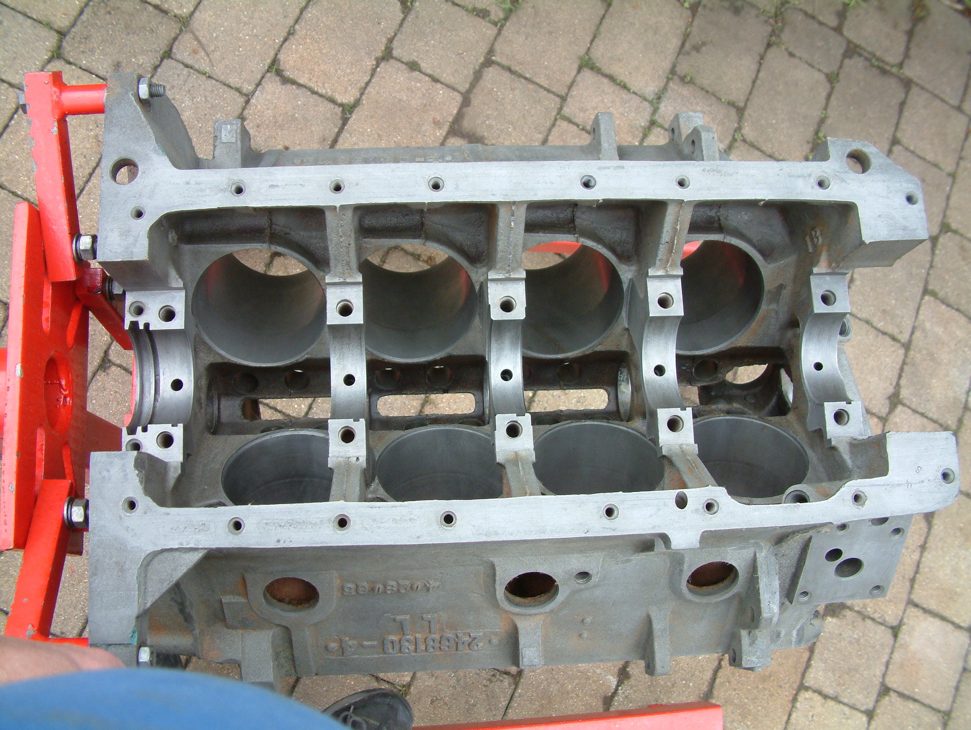

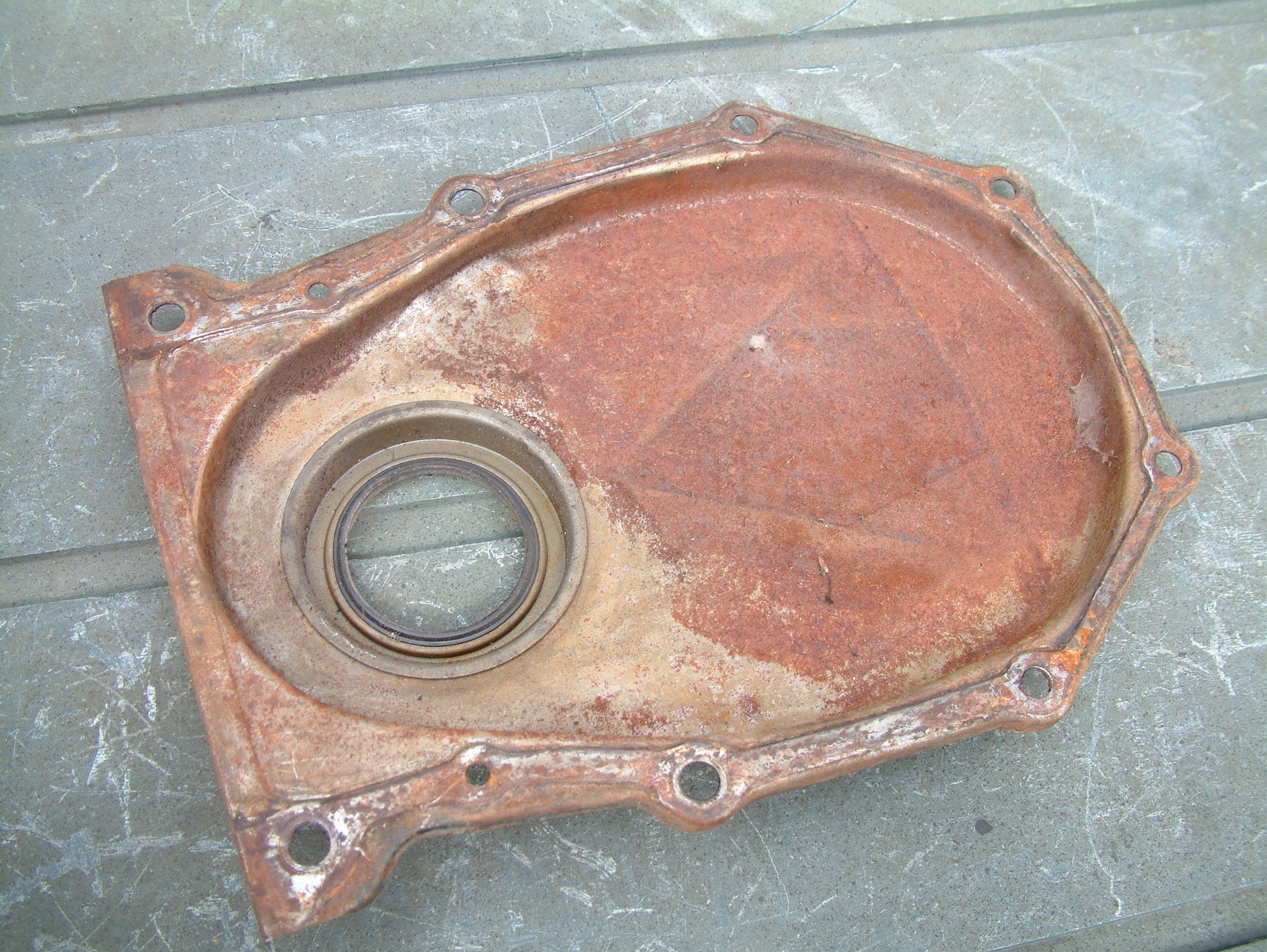

Some time ago now I got some Bilt Hamber de rusting compound "De Ox C". Having never used it...time just got away from me...I decided to give it a go.
It is billed as a non toxic de rusting agent that can be safely disposed of down the drain. The stuff comes as a fine white powder that is mixed with water. The concentration can be from 19 to 1 up to 4 to 1, depending on the severity of the rust. I mixed up a 10 to 1 solution for an experiment.

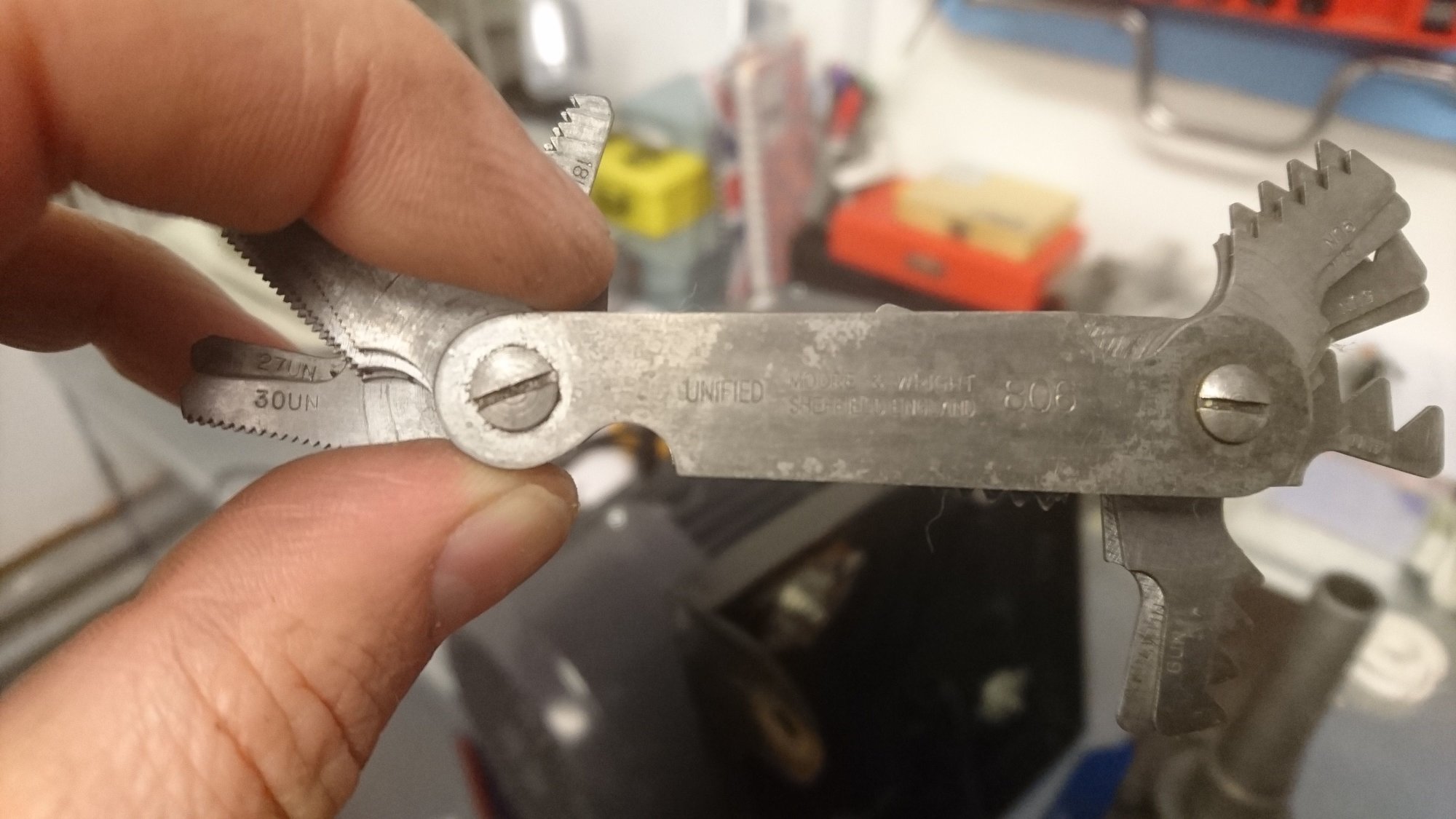

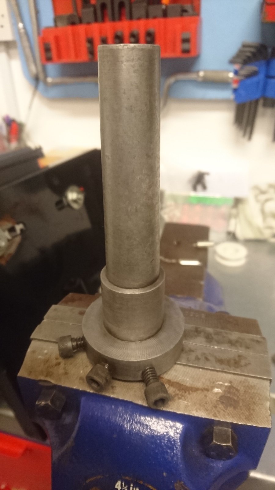

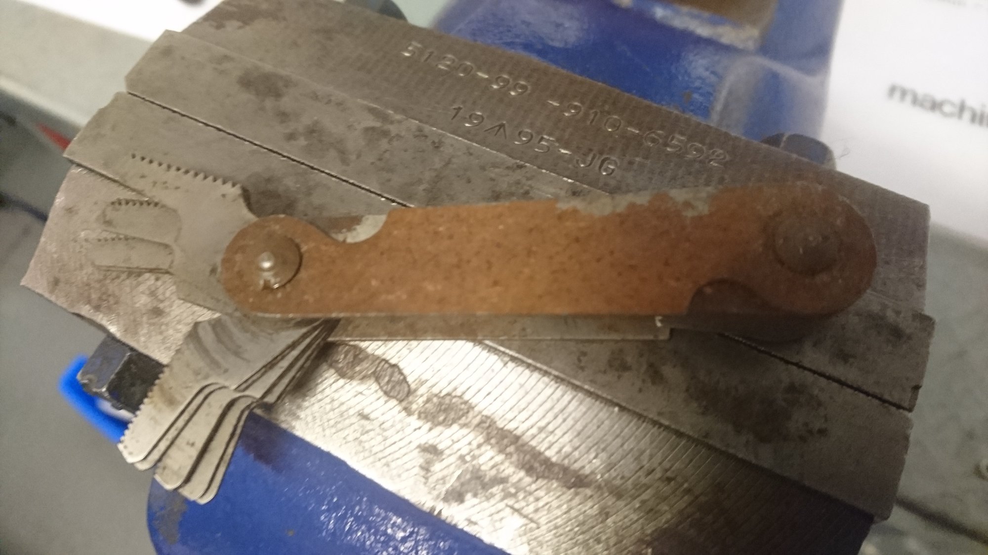

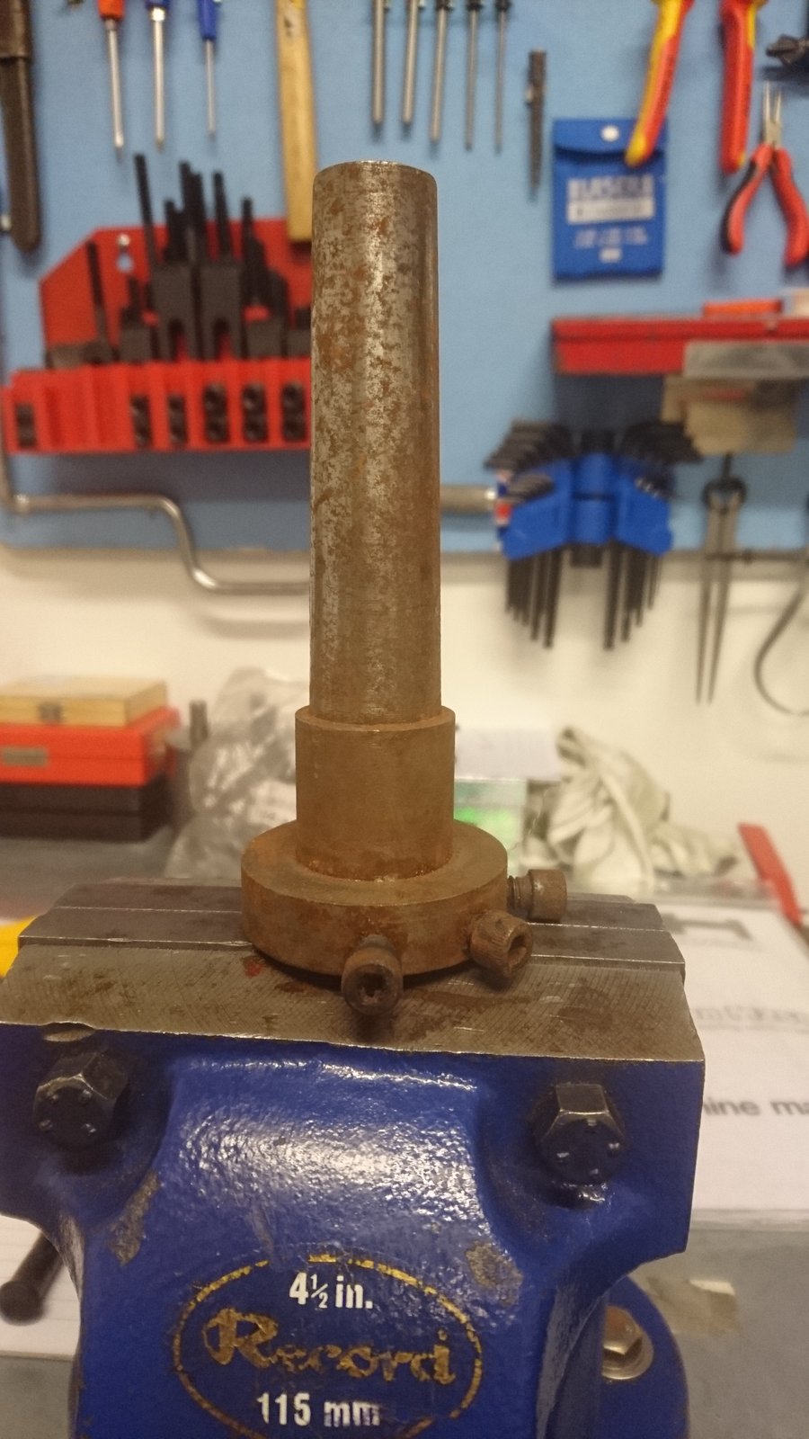

My Father in Law was a millwright and he gave me a few bits. One was a tailstock dieholder that was liberally coated in surface corrosion. Another was a number of thread gauges. The UN set of these was also quite rusty. These are shown below.
The instructions say to place the corroded items in the solution for anything from 20 minutes to overnight. As soon as I put the parts in they started to gently fizz. I left them overnight. Next morning I removed them and dried them, applying a little water dispersant (GT85) as per the instructions.
The results speak for themselves.
The stuff definitely works. You might say I could have achieved the same result with elbow grease and emery or scotchbrite. True, but you could mix up a larger batch of the stuff in a bigger tank for larger pieces that have hard to get at sections.
The question remains though, what is the stuff? I'm thinking possibly either citric or oxalic acid, or a combination of the two?
