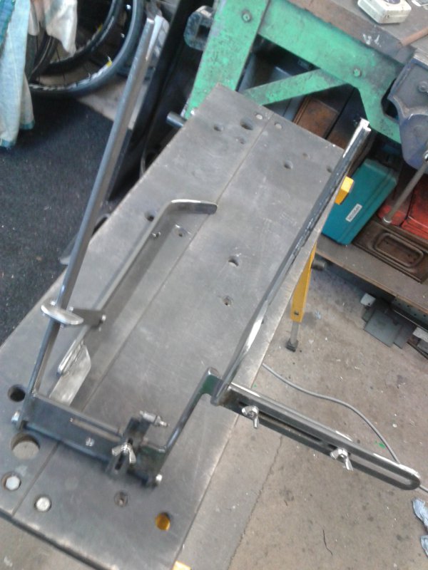

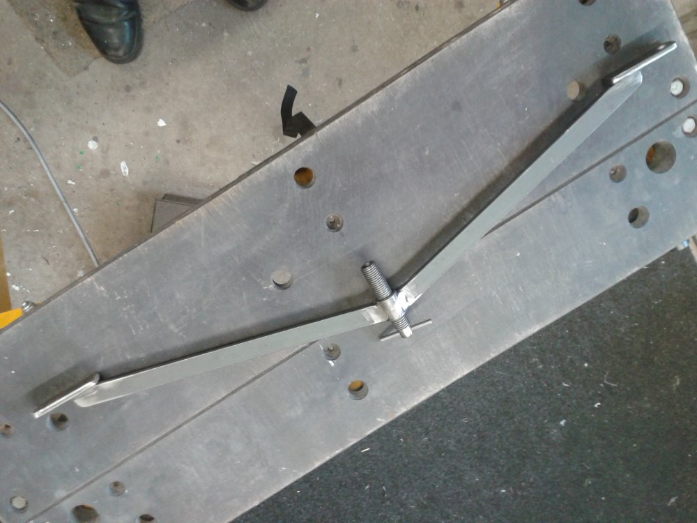

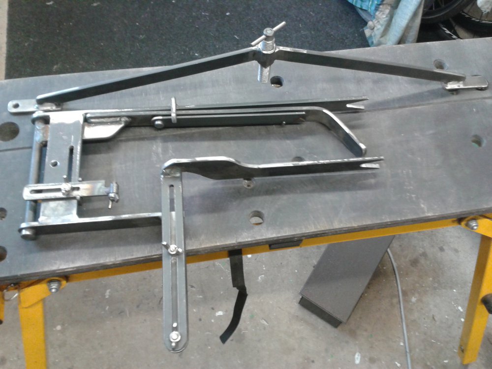

I made some wheel building tools years ago but the design of dishing tool I came up with was fiddly to use and the truing jig would only take 130mm rear hubs - my latest touring bike has a 135mm rear hub. For a while now I have been working these up between other jobs - I'm hoping the new truing jig will take anything I am likely to come across including tandem rear hubs.
The truing jig folds flat for wall hanging with the dishing tool.
Truing jig adjusts for a good range of hub width and rim size (most of my wheels will be 700c)
And the dishing tool
Just need to paint them now.
