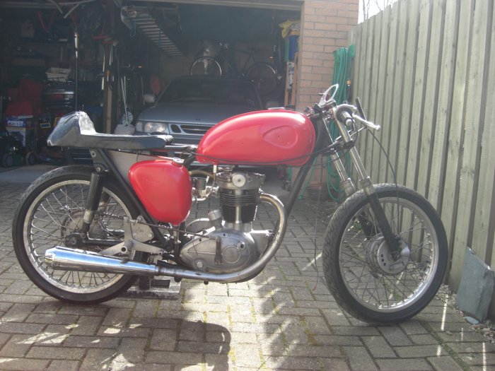

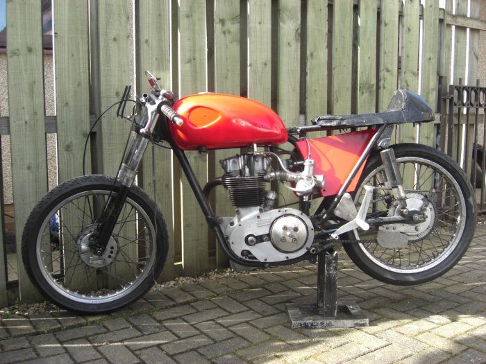

As promised last time here are a couple of photos and a brief spec:
BSA C15 250cc 1961ish.
High compression Rocket 3 piston.
Lumpier cam from the trials verion.
End oil feed to the crank.
Back to back Bantam fromt brakes forming a twin leading shoe brake like those on the Vincents.
Runs on Methanol through an Amal 389 1 1/8'' carb.
All in all a nice bike to learn how to race on. I am looking forward to it immensely.
