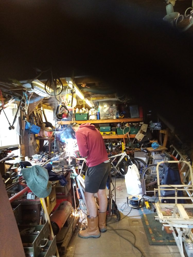

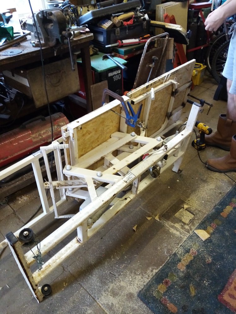

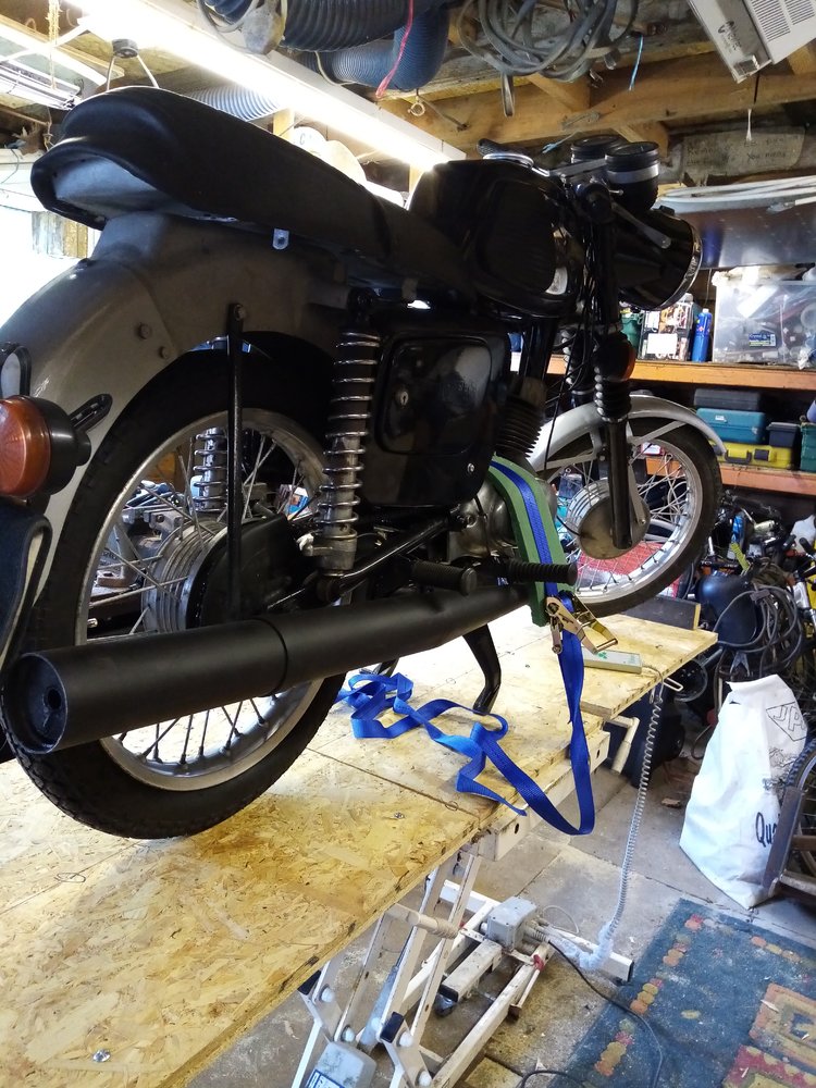

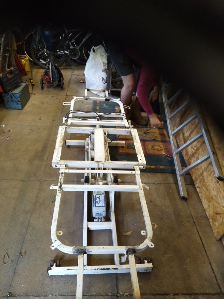

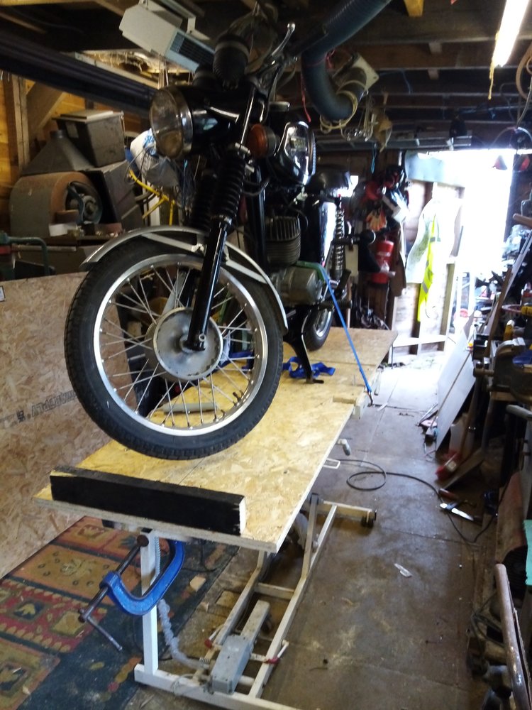

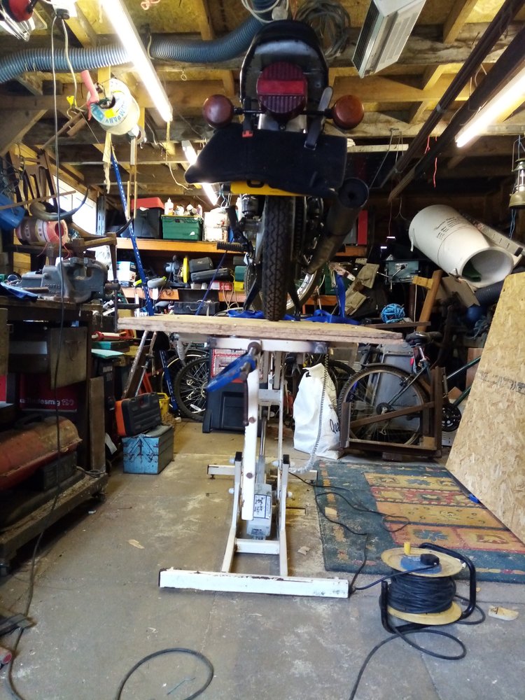

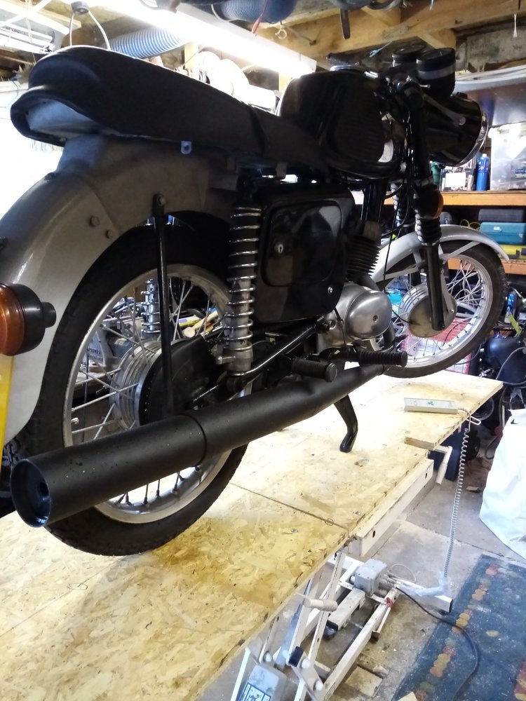

With just having bought an mz 125 and it needing a bit of fettling prior to having it tested. Me and wor Mick set about turning an old electric rise and fall hospital examination bed into a bike lift to save our backs.
the bike weighs in at around 16stone and the bed is rated for 25 stone. Really pleased with the result its good and sturdy and good use has been made of something that was going to be scrapped
