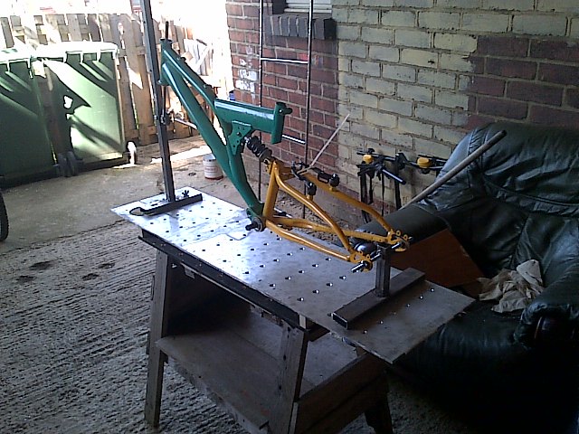

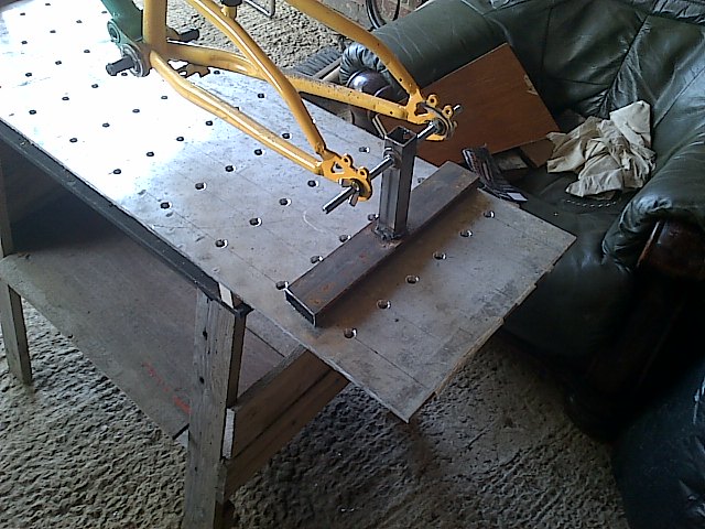

as im making a few bike frames at mo thought id make table to make life easier.
frame on it is mtb one that will be getting used to chopper so been taking measurements.

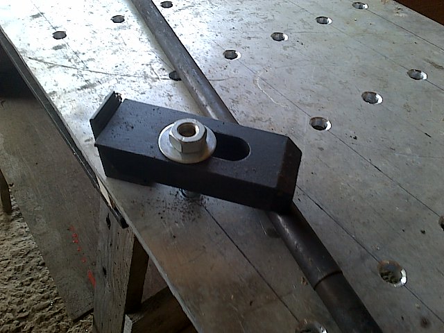

last pic is just some tubing clamped to it.

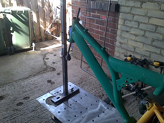

threaded bar holding head tube swivels and is ht adjustable.
table is from pce of 4mm ally out of skip.
