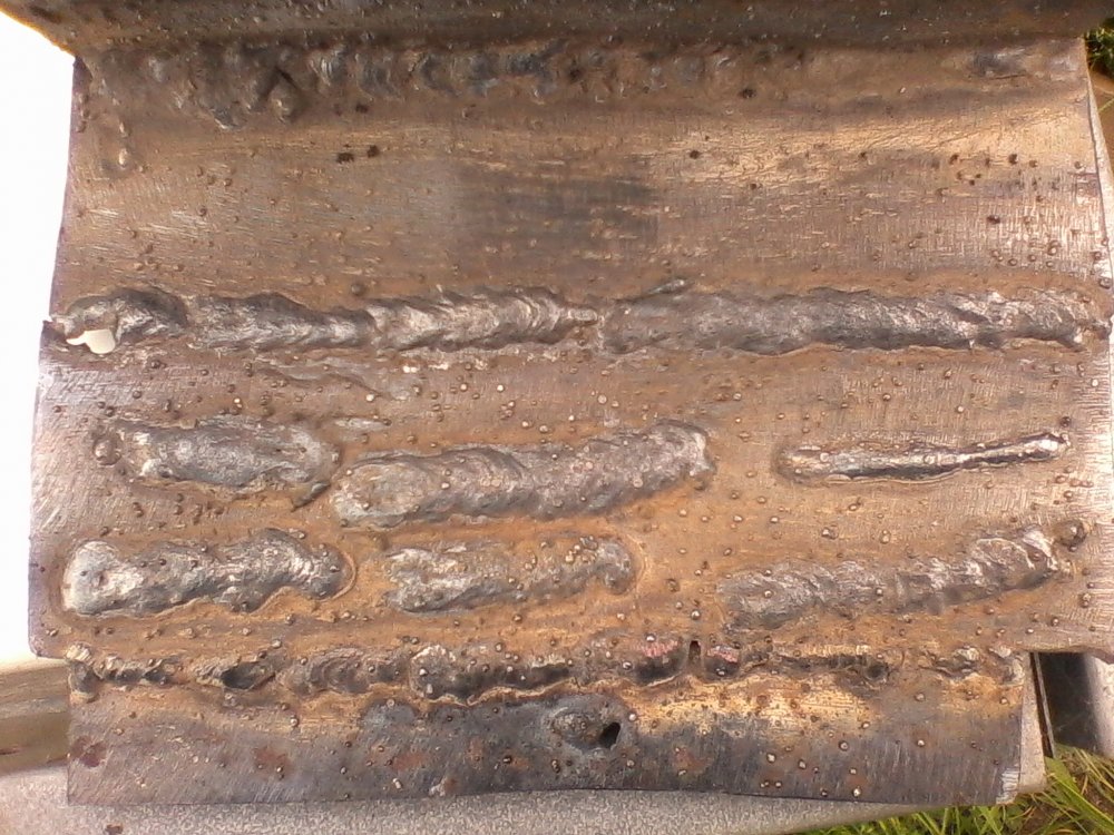

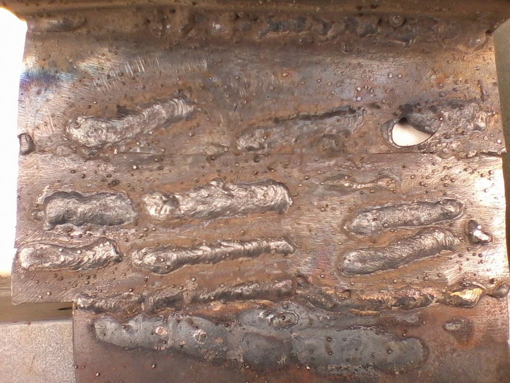

ok, so i have been playing with the welders for a while now. i just used the last of my bits of scrap to make a welding bench so that i can stand up instead of kneeling all the time. now that i have run out of materials for the other projects i decided to just practise.
i was told that a good way to practise was to get a plate and build it up with weld. so i cut a plate out of some old drawers to play with. its 1.5-2mm thick to start with, and i am doing MIG one side and MMA on the other. i started the first few runs with the last of a reel of SIP 0.8 gasless wire that i had left and was frankly rather disappointed. it was either going too fast and leaving a tall thin bead or when i slowed down it just blew holes through. i messed with the settings a bit and just got it to a thin but reasonable run before the wire ran out. the next lot is some Clarke 0.9 gasless and i cannot get the stuff to work, its a totally different ball game.
for one the slag is really really hard and properly black and takes a good smack with a hammer to chip off. the SIP stuff had a thin layer of chalky light brown slag that came off usually with a brush. even once i had thickened the plate up a bit it was still unruly and i could not get one complete run without either blowing holes, getting build up or having gaps in the run. i dont really understand it. i have done acceptable welds on many thing before with the 0.8 gasless stuff. i made the exhaust for my land rover with it and that pipe was really old and thin, i also made a tyre bead breaker with really thick stuff and got nicely lapped joints. so i dont really get what i am doing wrong.
the welder is a clarke 151en, i have tried it on every setting and various wire speeds. i can get the speed down to a nice consistent crackle without any lurches or burn back. the earth is close and clean and the plate was cleaned right back with a grinder before i started. it just seems like i have gone back to the level of my first ever welds.
i am still learning and i am doing this plate to practise technique rather than trying to join stuff. however there is no space for technique with this stuff because its too unpredictable. any advice or things to try? i would have taken photo's but there is so many runs it just looks confusing. i am going to grind them flat tomorrow and try again. i will get some photos then.
the ARC side is loads better, the only downside is the plate is a bit thin for the rods. but it still looks 10 times better than the mig side. at least the runs are consistent all the way.
