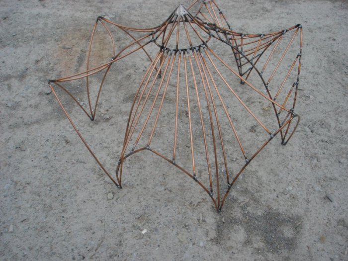

I made a small model. About 300mm tall. Working at this scale is great fun, lots of tiny spot welds and a quick result. I could not draw this for the life of me, and a model lets me get inside the structure.
I did three versions of the final cover for the dome and we selected the version above.

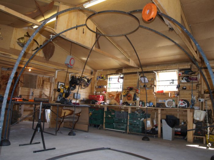

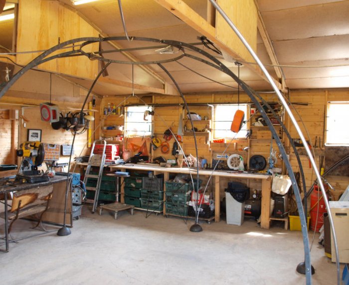

Next up was a half scale model of one arch way.
This had to be done to get a feel for the thing and to see if it will fit out of my workshop door in sections. It does. I framed off half the door and tried to see if it would work.

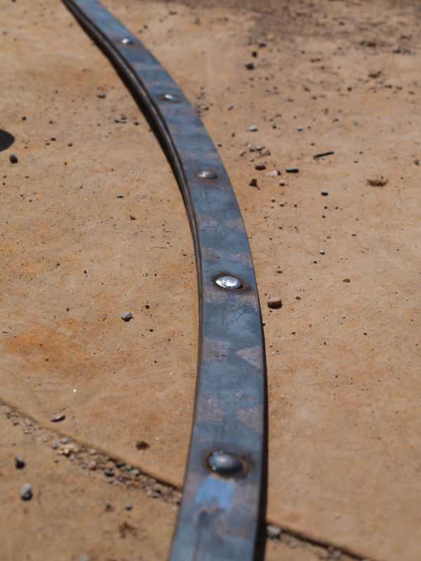

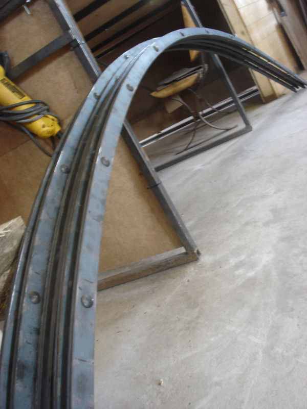

The vertical elements of the frame were going to rolled out of strip in pairs by a local engineer, the bolted together to allow for dismantling. He pulled such a face at the idea the pulled out so I did it myself with said Power Bender. 30x5mm strip on edge, by hand. It almost killed me a whole day going munch munch with a lever, each curve is 3m long, with small bends every 50mm along the length. The round bars in the full size version are half inch.
But ******myface off (as Grandpa used to say) it worked. Aint they lovely. I am using coach bolts, then once assembled I chop the other side of the bolt off and puddle weld it in place and it looks like a huge rivet. Photo's to follow. It gives a nice Victorian look to the end result.

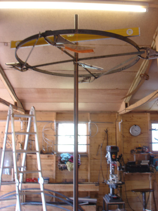

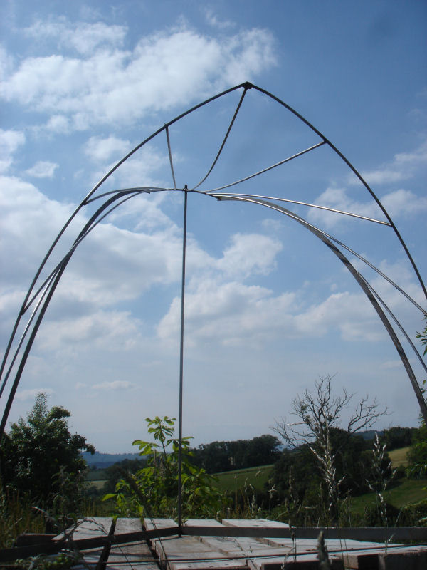

Today I got the top topp jigged up ready to weld the legs on on Friday.
I made the jig by eye, a length of tubing, three legs and a sliding tube to hold the frame. It even came out straight check out the plumbline. You cant the chock of wood that I didn't have to put under one of the legs.
Then we see if it works. My biggest concern is that with all the elements running vertically it might not be stiff enough lateraly. if this happens we have a plan for some bracing that will look part of the design.
