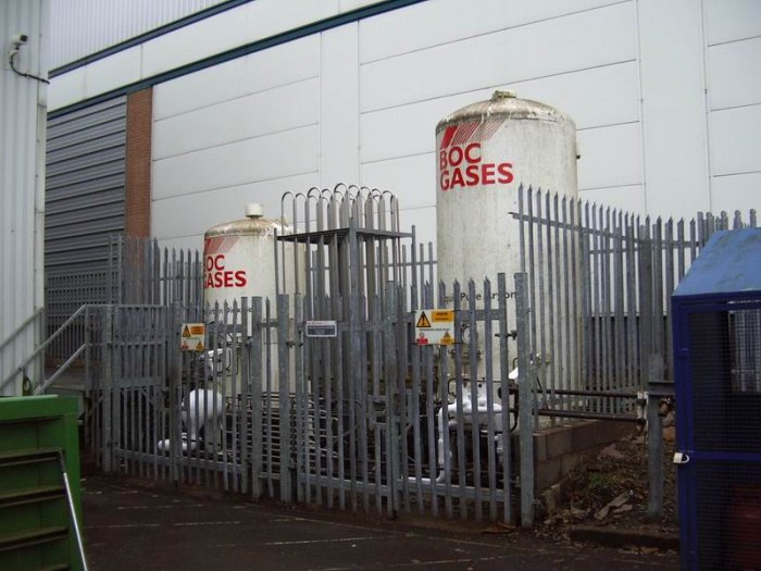

I like how the pipes are nicely frozen up
Tell me about it, my hands were frozen (even wearing rigger gloves) when I closed the valves for the christmas shutdown
From the ice they're liquid argon cryogenic tanks aren't they?
I like how the pipes are nicely frozen up, a day's welding in the garage gets the regulator pretty cold, but I'll never build up that much ice!
It certainly is, in my situation at home with either compressed air or welding gas cylinders.The frozen pipes are not really anything to do with draw off rates
Why isn't the whole cylinder covered in ice?The liquid in the vessels is stored at around minus 196 deg C
18 bar isn't that high?and around 18 bar pressure,
Not the case with cryogenic vessels, remember the temperature differentials involved when dealing with cryogenic liquids, it's a totally different situation than with cylinder gases
It is actually a vessel within a vessel, like a huge thermos flask with a vacuum and super insulating material such as Perlite between the two vessels to reduce temperature tracking, if you get a build up of frost or ice on the actual vessel you've got big problems
You will only need above 18 bar if your end application requires high pressure such as some of the new generation lasers that need in excess of 22bar at the cutting head. Most piped shielding gas supplies are around 2 to 3 bar.[/I]
QUOTE]
after a heavy welding session with long rins with the mig my regulator starts to freeze up on a large bottle, so id say its everything to do with draw off rates.
Thanks for the info. Given that you can't have a perfect vacuum, and therefore a perfect insulator, what is used to keep the liquid gas that cold?
It is a mixture of the vessel insulation and the pressure it is stored under, you are right to say you cannot achieve an absolute vacuum but it is as near as dammit, there is very little temperature tracking from the outer to inner vessel
Presumably the expense of keeping the gas cold is justified by the reduced running costs? Or, is the liquid allowed to manage itself, with an amount of 'boiled off' gas residing at the top of the cylinder?
As you say it virtually manages itself with no running cost, dependant upon the application you can either draw off liquid from the base of the vessel or gas from the top, these things are fairly carefully calculated with regards to peoples consumption because if you do not draw off enough product the gas pressure rises in the vessel causing the safety valve to lift and vent product off to the atmosphere
Where is the liquid allowed to revert back to a gas? it doesn't look like those pipes are insulated, so is the conversion managed near the tanks, with heaters etc to stop the pipework freezing up?
The liquid starts to turn to gas as soon as it starts to leave the vessel, it usually goes through a series of vapourisers (tubes with fins on them) which aid the vapourisation process and raise the pressure with no need for any form of heating, if the application requires liquid the pipework is all super insulated and no vapourisers added
