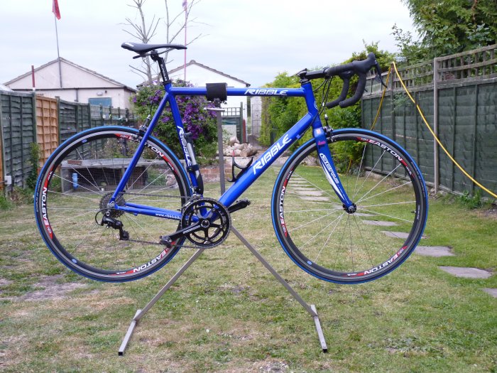

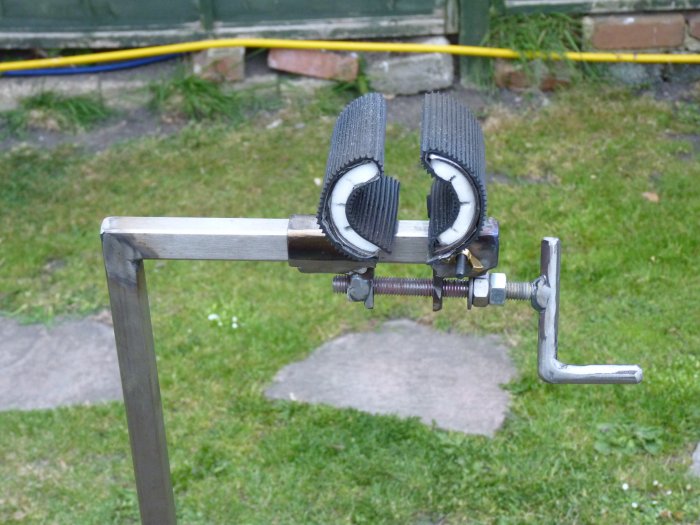

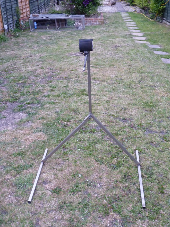

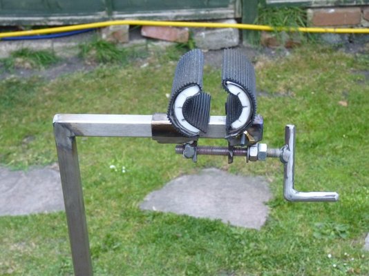

I've had some 20x20 stainless box knocking around for ages and finally decided to do something with it so I knocked up this simple bike workstand this afternoon.
Seeing as it's a non-critical item it's migged using mild steel wire and 95/5 argonmix.
I would have preferred to tig it but I took my argon cylinder back as it was sat idle most of the time.
A little more cleaning up and a couple of mods required, one being a tool tray and it's sorted.
