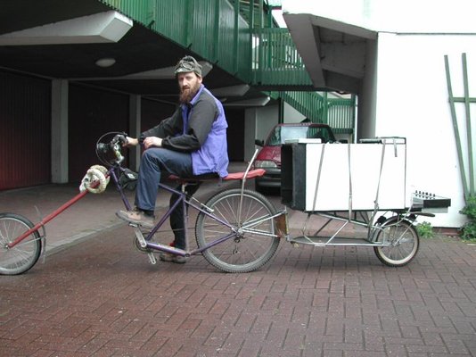

The frame of the trailer was SS 1" tube. Dear old Dad made several such crude ones back in the 50's.
I bought this before I learned to weld, a simple device, vertical pivot in front of platform, horizontal pivots around little sticky out bits on the rear quick release.
Mr Joker,
How is the trailer going to pivot up and down over bumps etc?
Or have I missed something? this stuff is kind of fun though.
Chunko'.
It, first of all, depends on where the trailer will be attached. Once I've figured that one out, we'll see how. If I were to attach it to the frame close to the rear hub, then I think the best thing is to have it pivot up-down at (or very near) the fastener. Then use an old headstock for sideways movement. If, on the other hand, it's attached to (or close to) the seat post, I think that it could, again, pivot up-down at the fastener.
