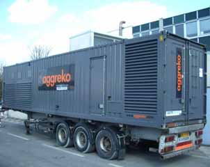

Only today did we have an issue, so thought I would post for members information.
If you use a generator and a welding or similar plant then make sure your generator has AVR or auto voltage regulation if you use an invertor welder as they are sensitive to incoming voltage as we have blown an invertor welder today.
As a company we use a national contractor to supply our generators for sites with no power, or insufficient power for our needs and the contract with them stipulates that only AVR generators are to be supplied, today one slipped through the net and we were supplied with one generator without AVR and welder went bang.
Fortunately two generators were delivered, and this project only started on Monday and the prep work is in its infancy so only one welder was working, and they had a spare.
