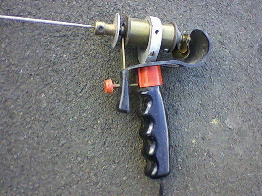

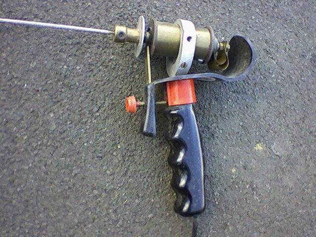

Well as promised I set up the toy welder, first on one 12 volt battery and using a 2mm 6013, all that happened was a bit of vibration and a few sparks, no arc at all, so joined up 2 batteries with jump leads and tried at 24 volts, slightly more vibration and bigger sparks, still no arc, so then hooked it up to a dc inverter, no vibration and a nice smooth arc, just like a regular electrode holder, so it either has a fault, or is as I have always suspected a waste of space, either way I've wasted enough time on it and its now back in the box of random rubbish under the bench and probably wont come out again.
