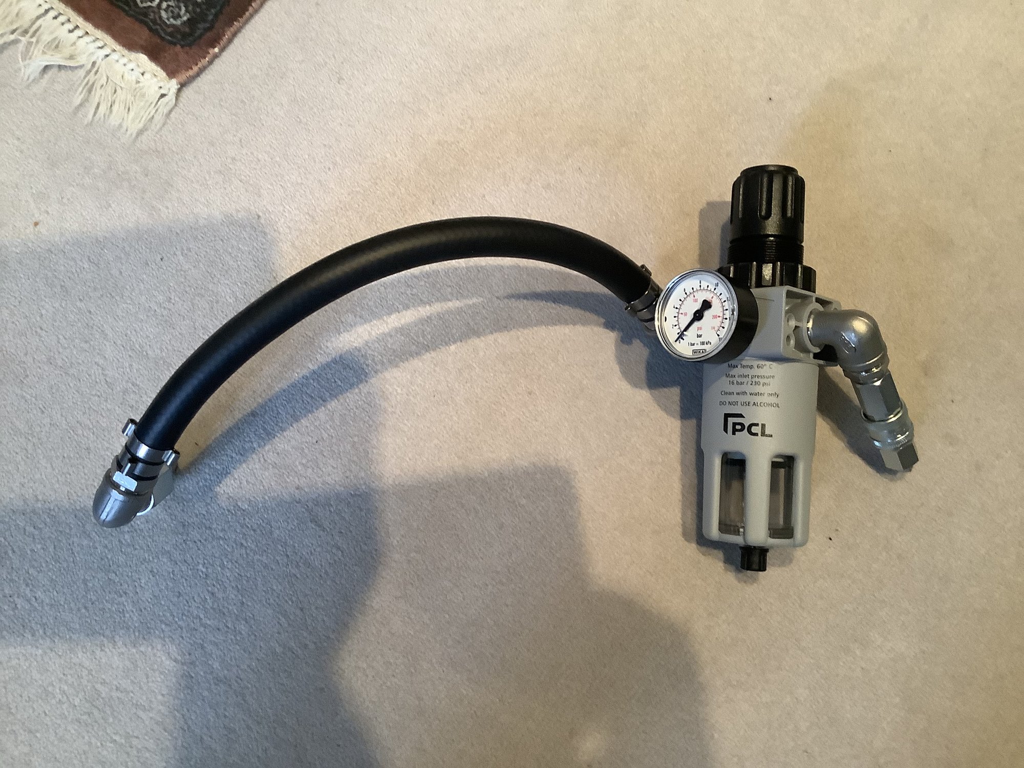

whats the best method to “retrain” or bend this hose 13mm ID 21mm OD?
Gentle use of a heat gun, or pour very hot water over it ?
My initial thoughts are to heat with a heat gun progressively, until hand hot, bend and lock into the perfect position; leave it constrained to go cold and hopefully take a set with the correct bend.
Will it set back in a new position?
How long would you leave the Loctite 577 secured fittings to cure before applying the bending pressure? Its now had 38 hours. Or would you leave it the full cure time of 72 hours?
Definitely don’t want the joint to the Filter (which was just rotated to the correct position) to be compromised ( note I had problems with ptfe tape 14 winds to lock up)

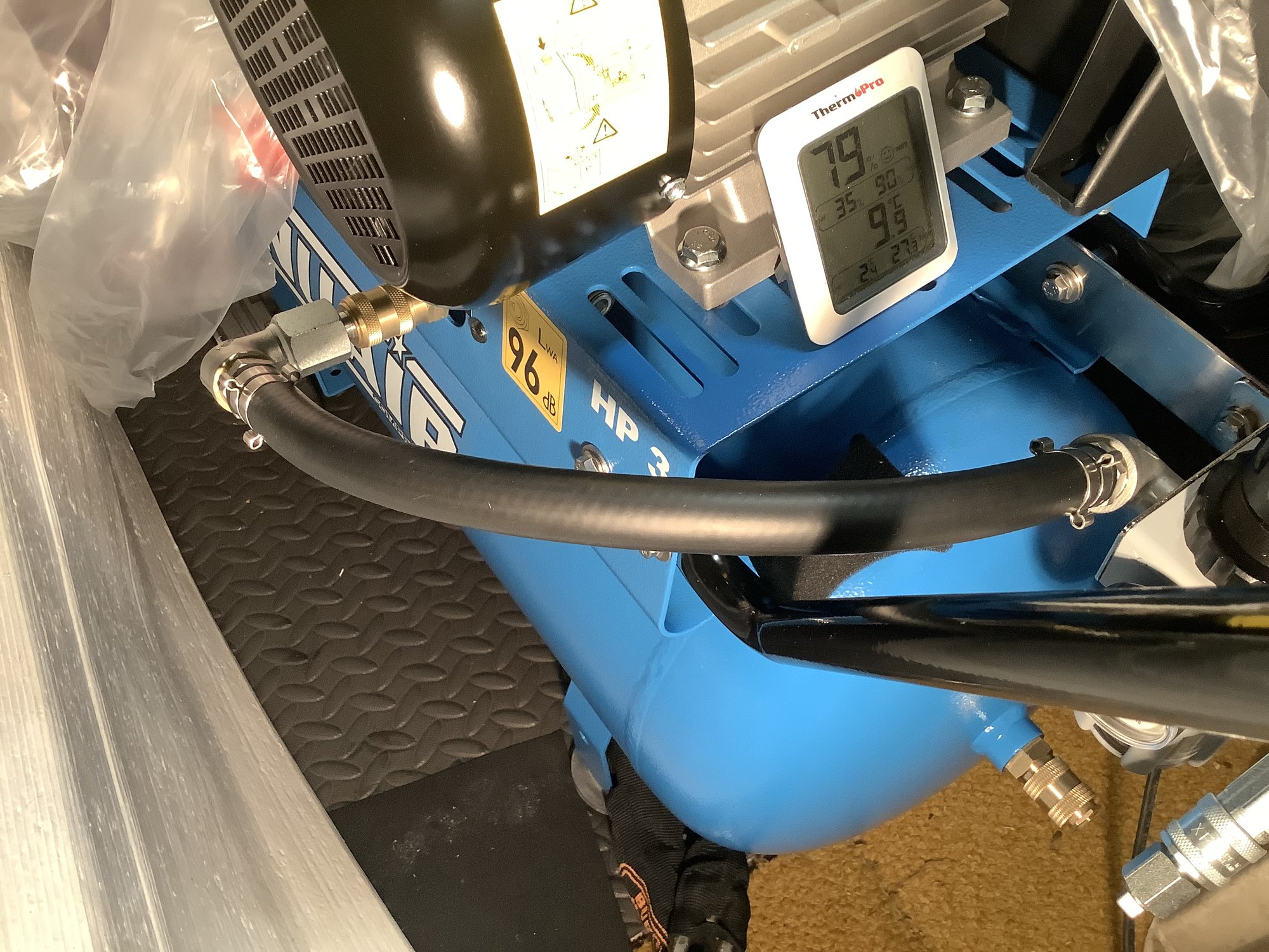

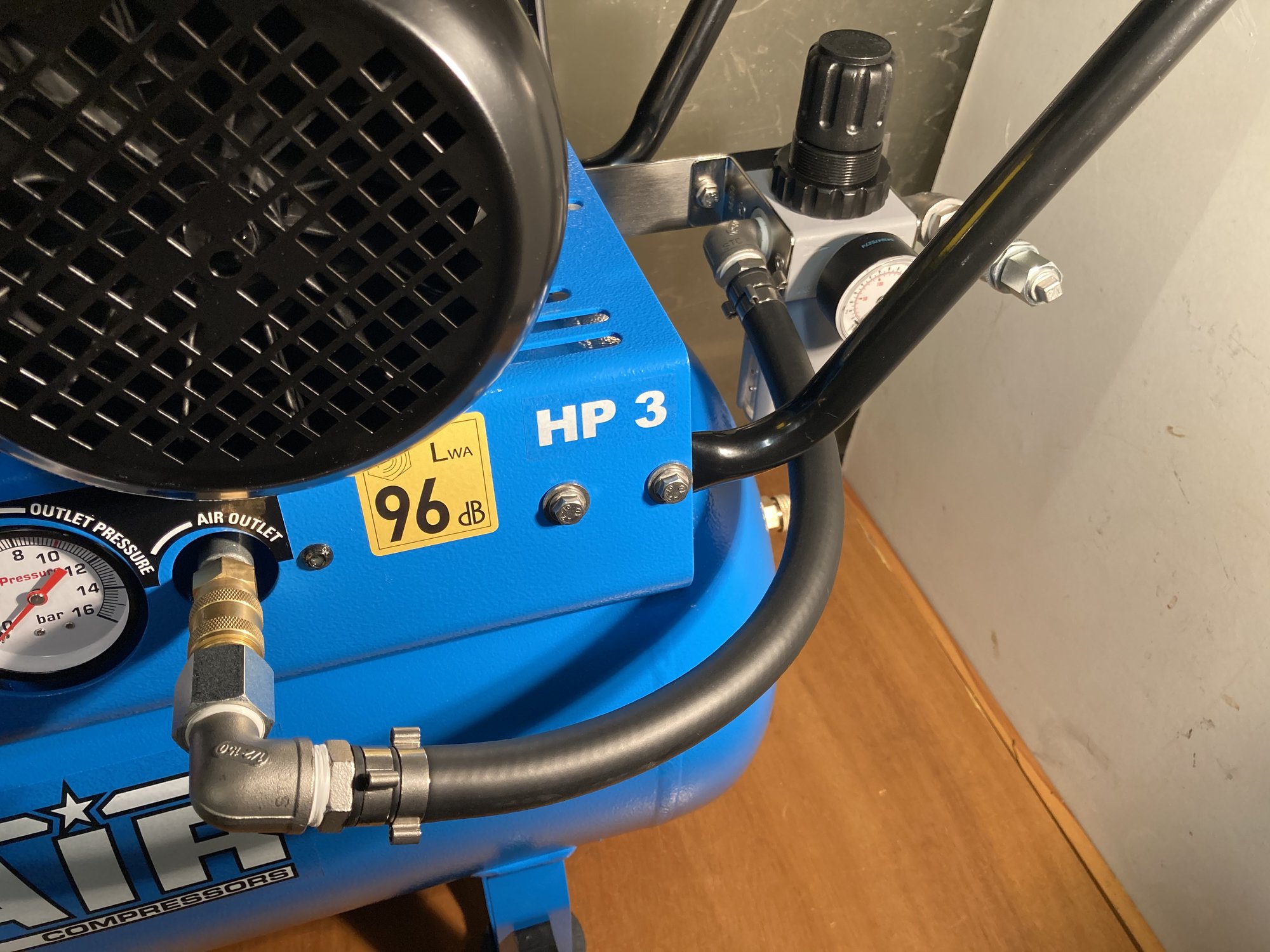

I cemented the fittings in with Loctite 577, and I need to bend the hose in the opposite direction.
I could have rotated the fitting back 180 degrees, but went for the fitting being locked up.

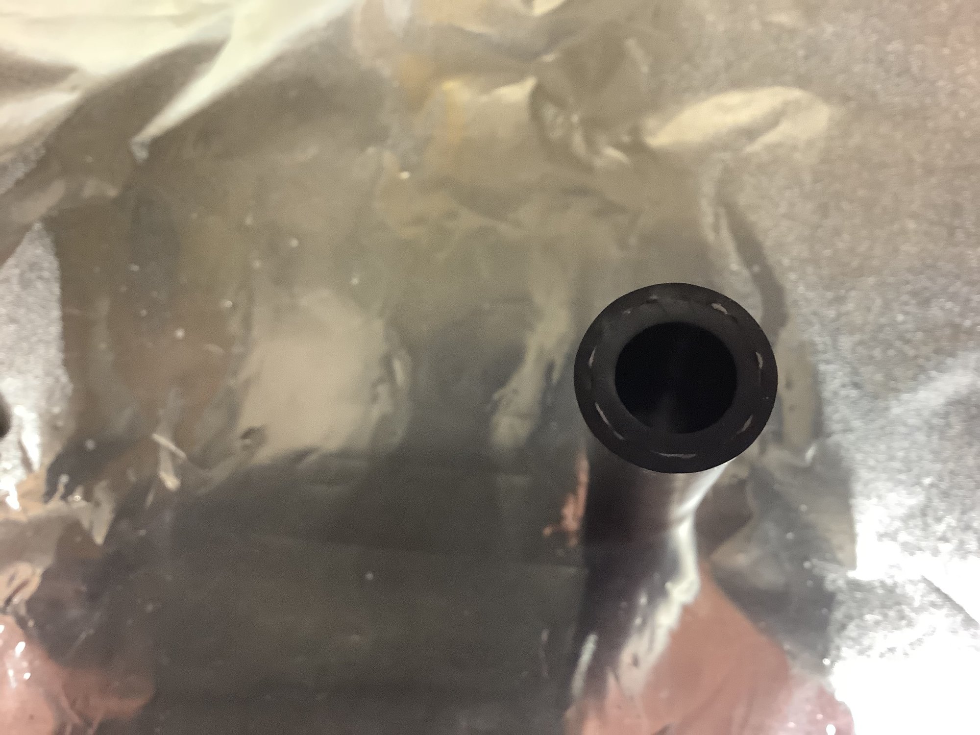

Unfortunately it had been wound in a 1ft circle, and has taken a set. Its quite stiff.
I really wish I had left the hose crimps till last - lesson learnt
