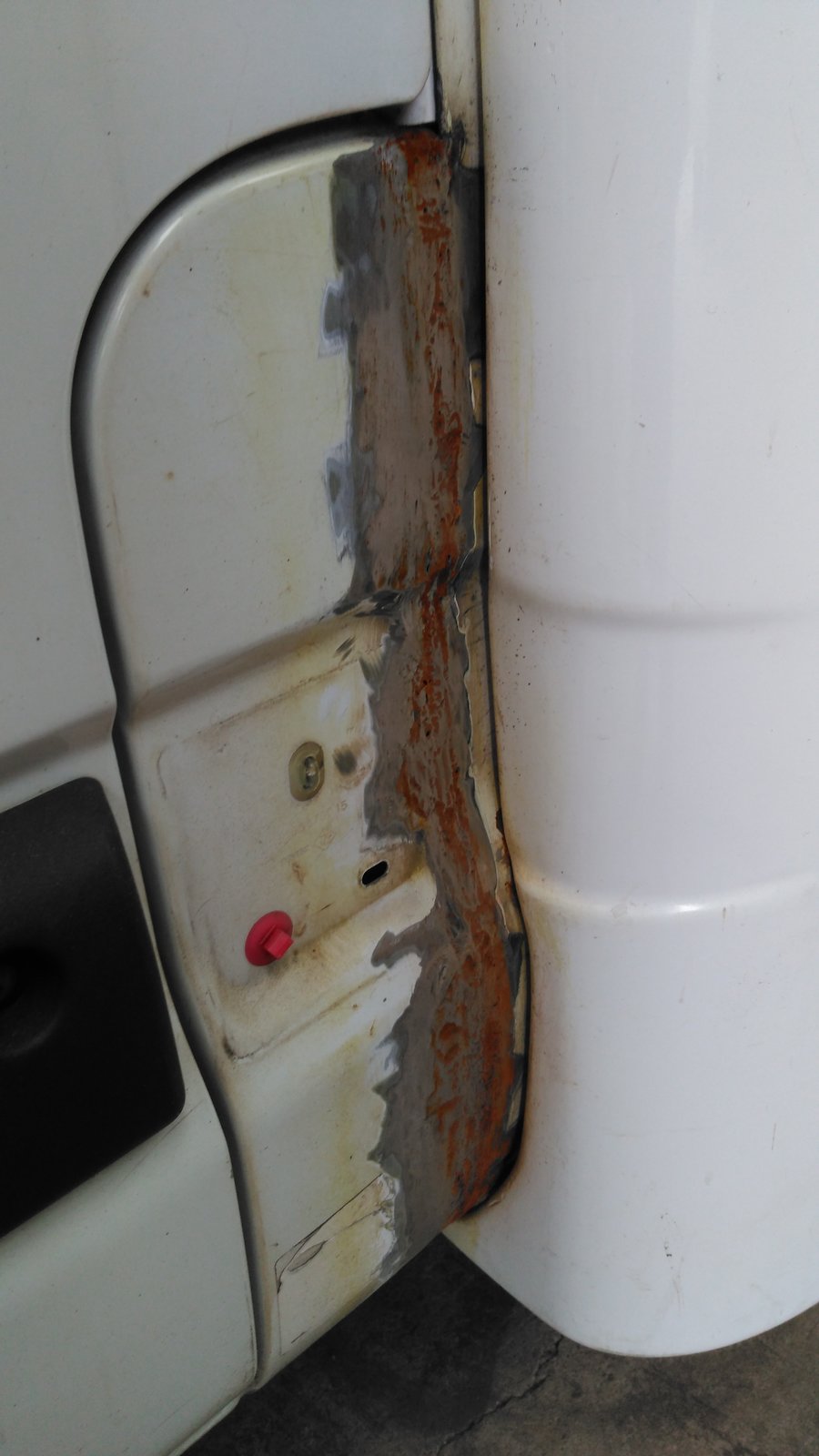

get it clean before applying anything , i used to use upol galv x , which was good stuff & it used to stick to plastics as well, dare say theres summit new out probably better. can u get to the rear of the panel where the weld is and give it a good blast of waxoyl because it will rust out at an alarming rate if not treated with something.
