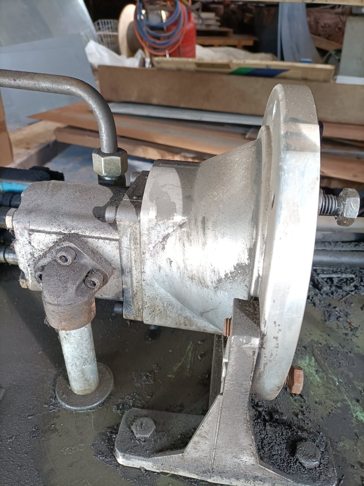

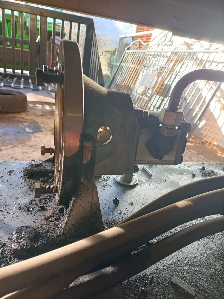

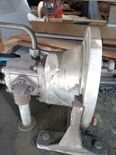

Recently bought a geka 80 steelworker as a spares or repair project
All looks mainly intact apart from a a few little bits which I've had a price to replace
All seemed reasonably enough priced apart from the motor to pump coupling which was £430!

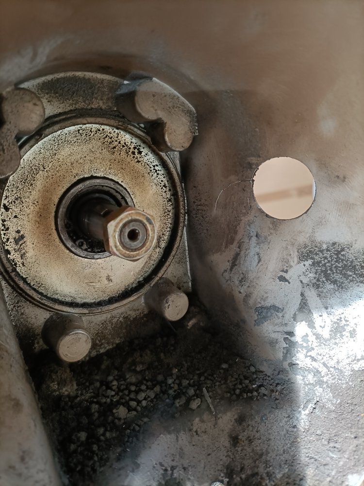

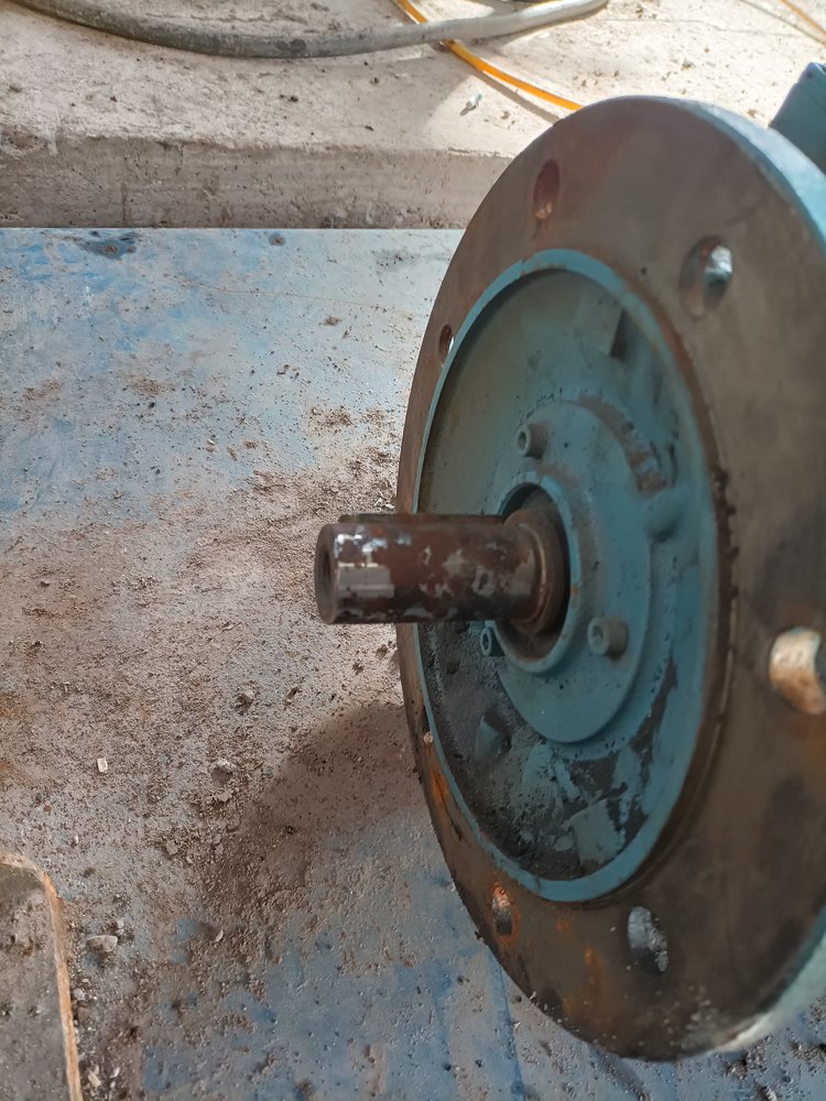

Basically a 28mm parallel keyway shaft on the motor which isnt a problem but.....

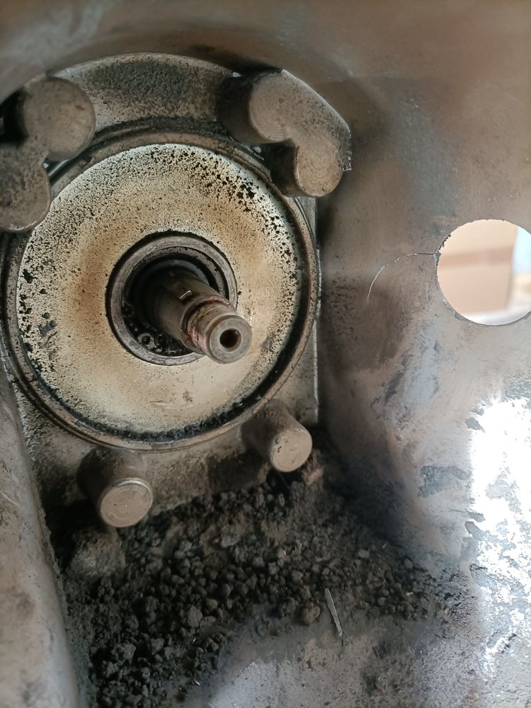

On the hydraulic pump side theres a tapered shaft which i can't seem to find a off the shelf fitting for
So I'm thinking 2 options of either build the shaft up to a standard size parallel then machine keyway back in
Or i can buy a blank taperlock fitting and machine the taper
Taper is approx 15mm one end 17mm other end and 21mm long with a m10 thread to hold the taper on
Few pics attached to hopefully make it a bit clearer!
