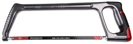

Guys,
need your help on a new tool to help me cut up some steel on site BUT I cant use hot works so no grinder, I cant even use a recip saw or circular saw due to noise so i am limited to what i can use as you can read,the steel is about 6mm from angles to plate its a rip out in an airport so public will be close so that is why,
anything you can think of i can use to help would be great,
Cheers
