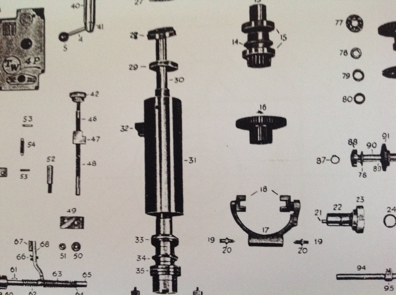

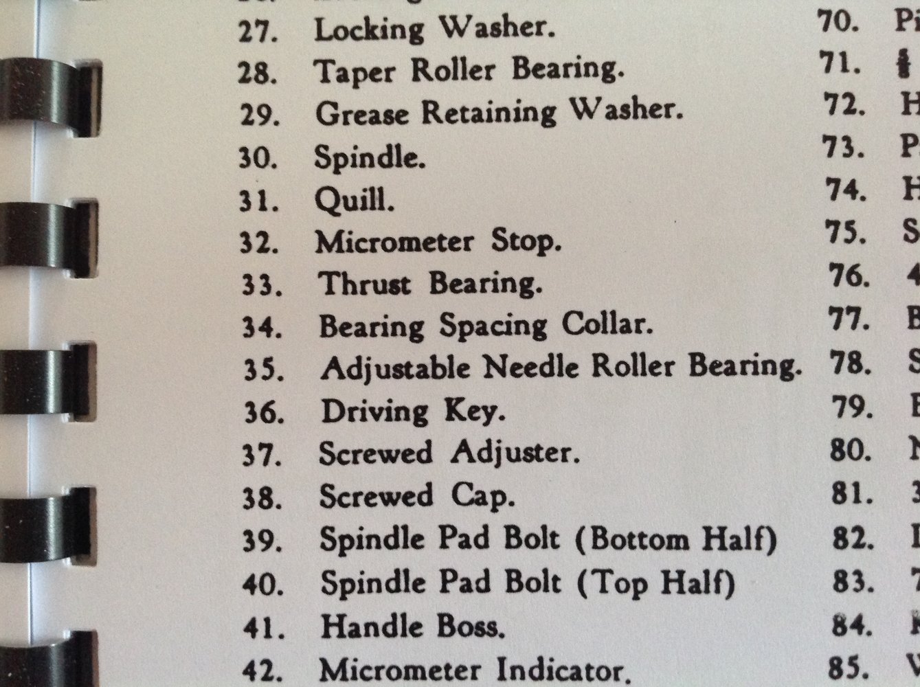

From the top.What takes the axial load?
Tapered roller, timken number
Big gap
Flat thrust bearing, unknown number
Needle roller, unknown number
That's it
So the needle roller is critical, in fact they all are. The tension on the timken is st by a tabbed nut, which is hand tight - no spacer tube. I think this is a bit pants myself, but it seems to work.
