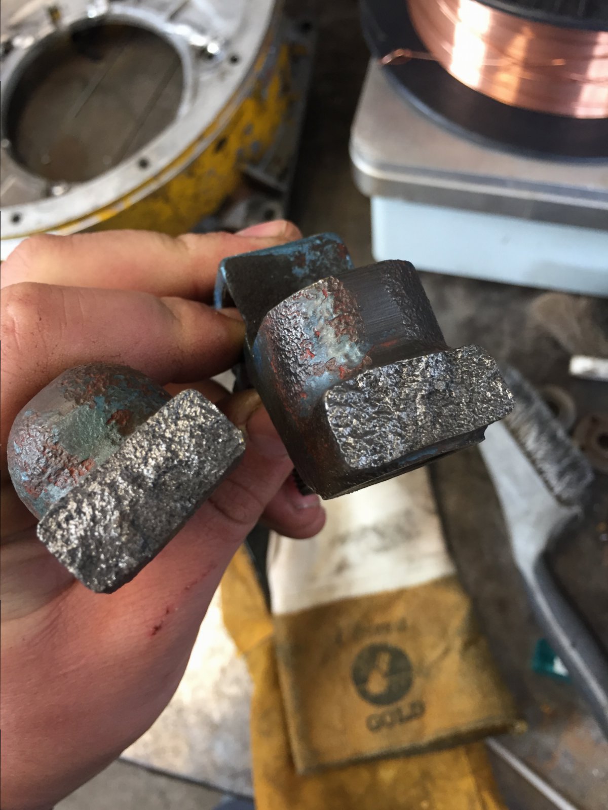

Got this to weld up, a handle/arm for a tapping drill holder that has snapped. Looks to be quite a large grain size.
I've got silicon bronze tig rods or oerlikon Citocast stick rods and some 1.6mm Nickel Alloy stick rods (for cast and creep resistant alloys iirc) that I could break the flux off and tig with.
Preheat and keep hot or small cold welds and peen?
