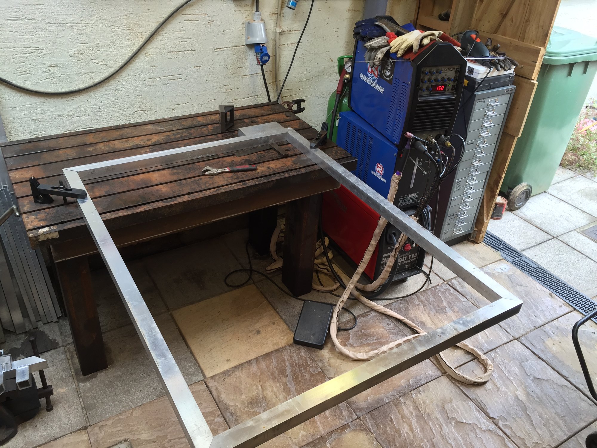

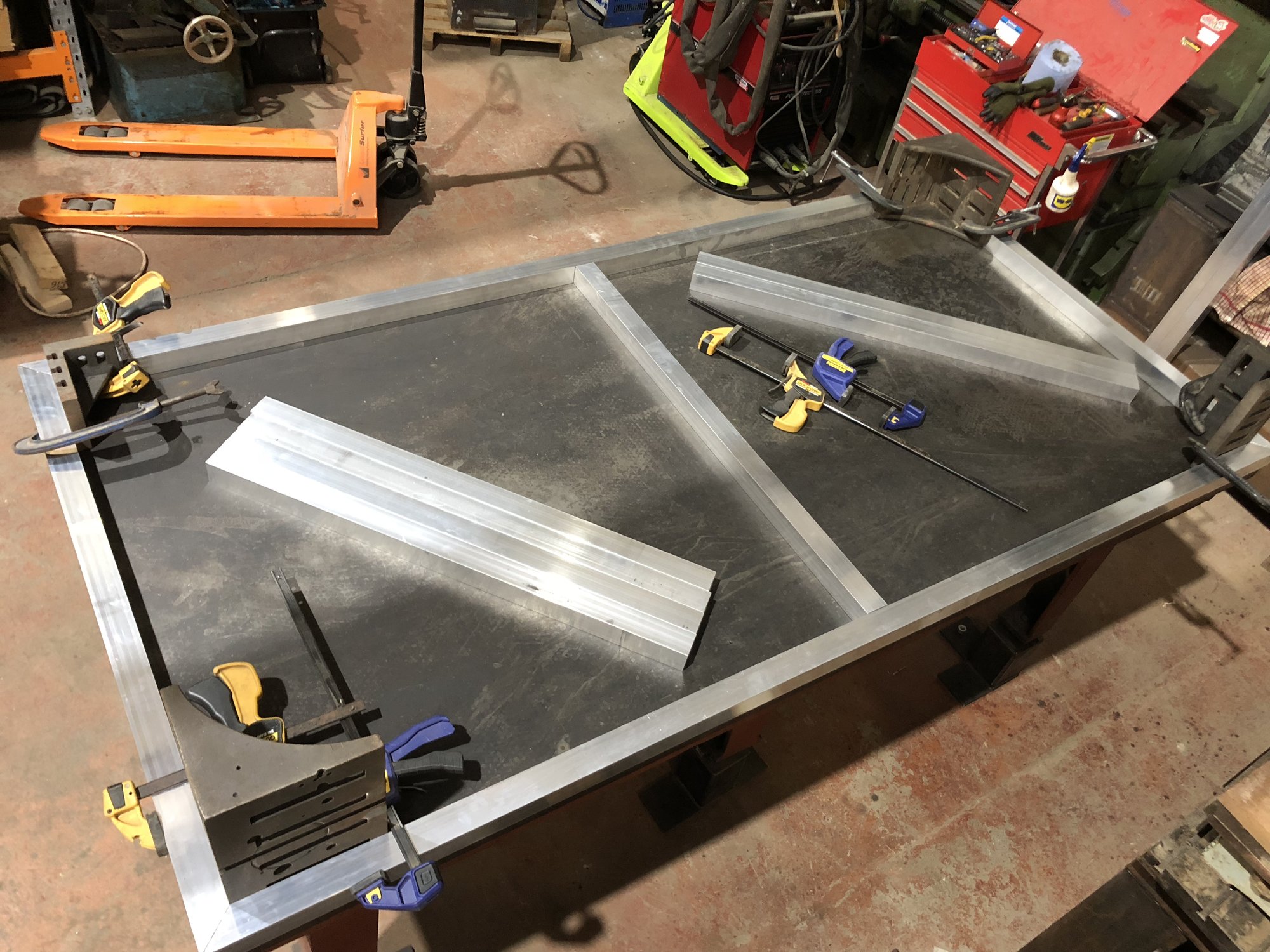

If your sheet of 10mm is reasonably flat then use that to lay out a frame of 50mm shs.
Tack the entire frame before welding it all up.
Once the frame is welded, stiff and square then tack the 100mm plate onto it.
Thanks again. Out of interested would you be interested in building the top plate for me. If so let me know how much £££ you would charge as it would be nice to just get it done without me messing it up again.
