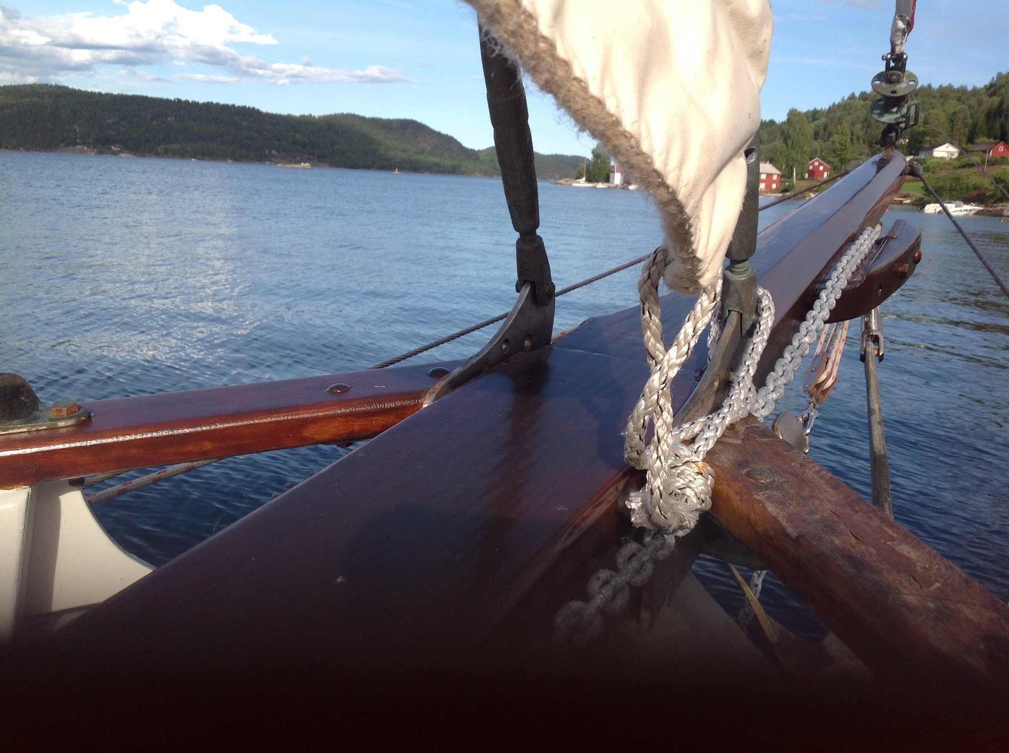

Decking is high maintenance, replace with concrete which is low maintenance....can we see more of the boat!View attachment 149121 International Cetol Filter 7.
I have been putting it on the bowsprit and capping rails of my boat, it takes a while to set hard, 2 or 3 coats unless it will be chafed by ropes etc when 4 is better.
The same as International Woodskin (which is double the price because it is aimed at so-called classic yachts)
But Filter 7 is available in a wide range of tints as well, the darker tint the more UV protection.
Edited to add... in the piccie, on the starboard capping rail, is the traditional varnish which is peeling off like a champ..
the Filter 7 is on the port capping rail and the bowsprit

Show us your boat jerryView attachment 149121 International Cetol Filter 7.
