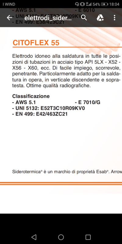

Citoflex 6010
Supercito 6013
Citobasico 7018
I also like cemont speedarc 6013 and bohler rods
But essessentially I prefer siderotermica cito rods
