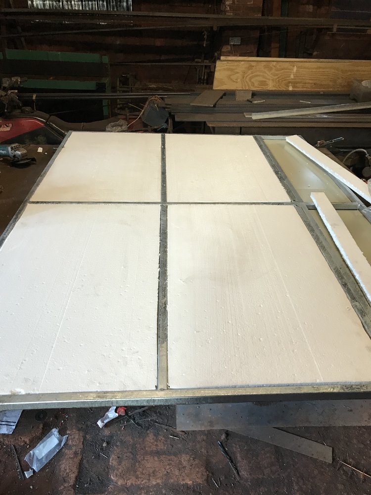

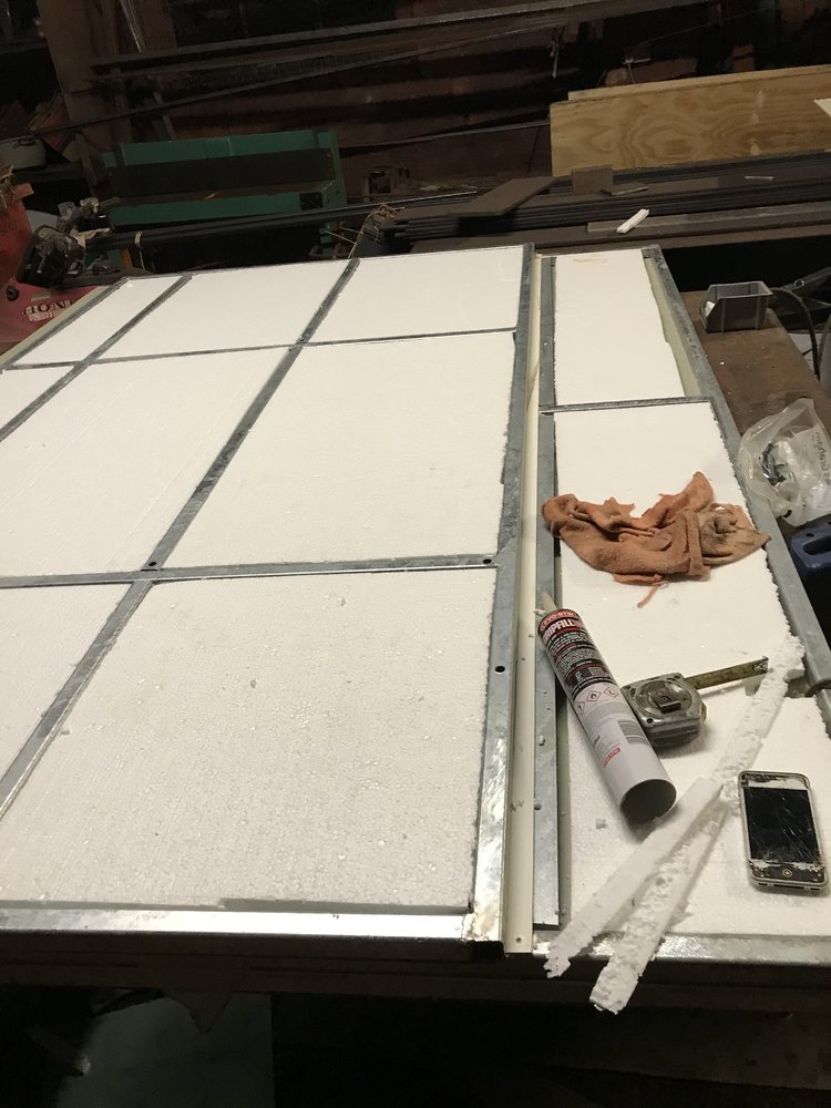

The galved frames have flat plastisol coated sheets with the poly inside as insulation then 3mm white pvc cladding on the inside, my trouble is.I’ve always used pan head self tapping screws with white heads to fix the white sheets on, no problems-until now I can not get them for love nor money!!they look like a door be warned
Insulating Steel Doors
Last year i put a new roof on my garage workshop, Also built new side opening doors for it to increase security. The new doors are 6' 6" high 4' wide made from 30mm box section steel with angle iron welded on to form a ledge for the panels to fasten into. Panels are 2.5mm galv steel. I lined...www.mig-welding.co.uk
if a side panel instead should have boarded it then filled it then claded it
or if an insulated thin panel same thing
so change your screw theres plenty out thereThe galved frames have flat plastisol coated sheets with the poly inside as insulation then 3mm white pvc cladding on the inside, my trouble is.I’ve always used pan head self tapping screws with white heads to fix the white sheets on, no problems-until now I can not get them for love nor money!!
so I have had to go the glueing route
