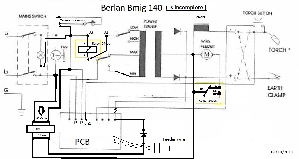

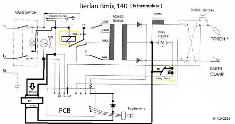

L linuxmadeira New Member Messages 13 Location Funchal - Potugal Oct 4, 2019 #61 schemes is incomplete esquemas_Berlan_Bmig_140.jpg 117.7 KB · Views: 252

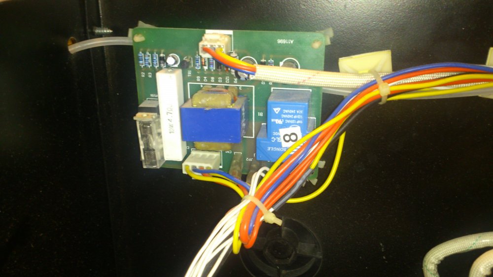

E eddie49 Member Messages 4,988 Location Reading, Berkshire Oct 12, 2019 #62 It's good that you have found the fault ! These little PCB-mounted transformers do fail.... for example, this recent thread: https://www.mig-welding.co.uk/forum/threads/esab-lka-150-problems.94311/ That one was 12v. To get a replacement, I would suggest searching for "encapsulated 24v transformer". Such as this one for 3 Pounds: https://www.ebay.co.uk/itm/BVEI3032...d-1-5VA-230VAC-24V-63mA-Mounting/312796456024 The pin spacing on the replacement transformer may not match your PCB exactly, you may have to adapt it with short extra wires.
