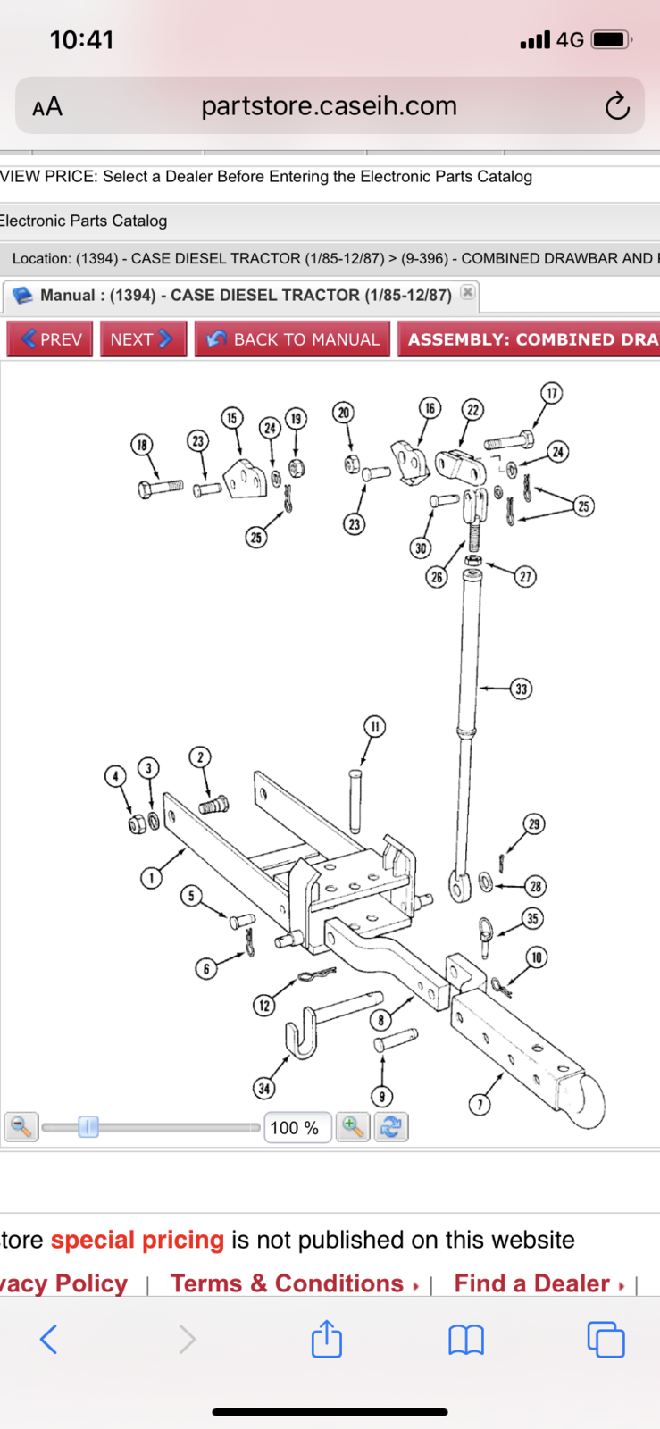

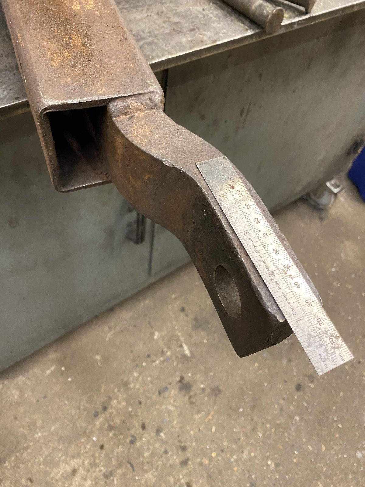

I need to make a new clevis strap for the tractor drawbar as it came with the wrong one fitted and doesn’t work well nor is it safe. I need to replicate the bottom clevis as shown hear:
It’s made from 2-1/2” x 1-1/4” and although the top clevis doesn’t support any weight it still needs to be something reasonably tough so thinking EN24?
The biggest problem is going to be bending especially with two bends so close together, dose anyone know ware I could get this bent or anyone able to help?
