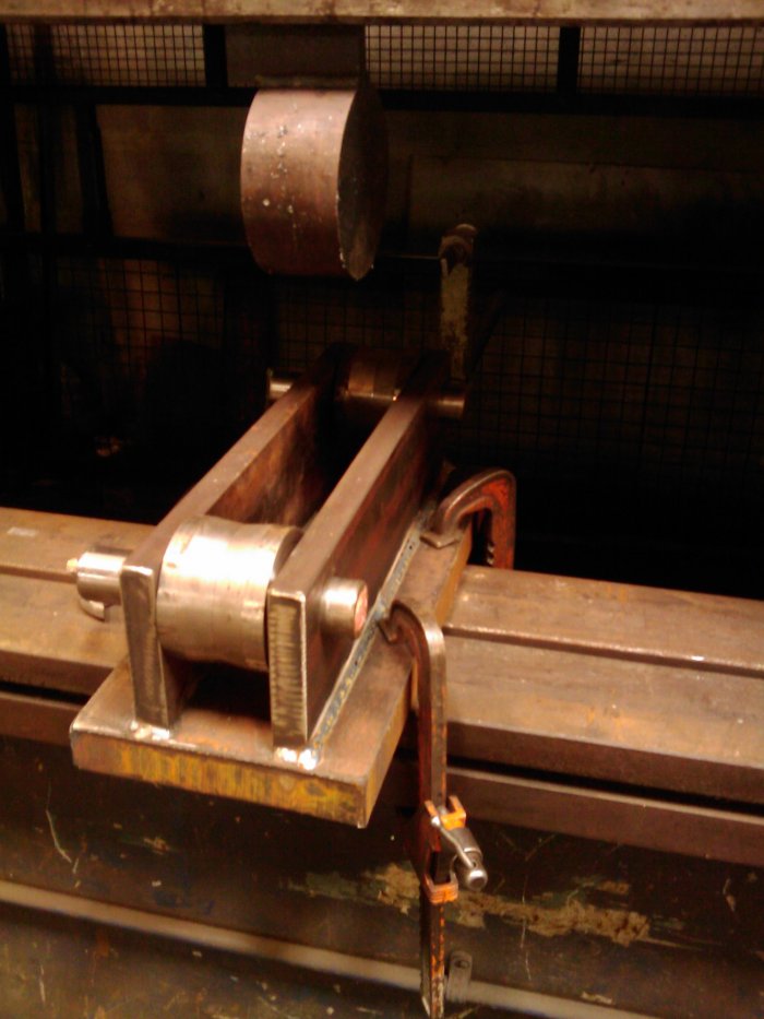

Made some tooling up today, rather than maths, i have used a bit of guess work....
Bending forces, to bend round bar, anyone know how i can work out the tonnage required? Might be one for someone with a fancy computer programme
Tooling is 100mm diam rollers, with pins through to allow them to rotate slightly, hopefully
Spaced at 400mm centres.
Top tool is a die from a tube bender, at a rough guess, 200mm radius.

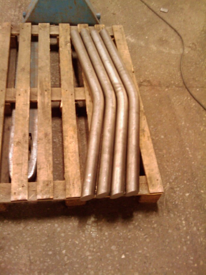

Bar to bend, is 60mm solid steel, but only to 21 degrees from straight.
My rough guess is somewhere around the 10 ton mark...
