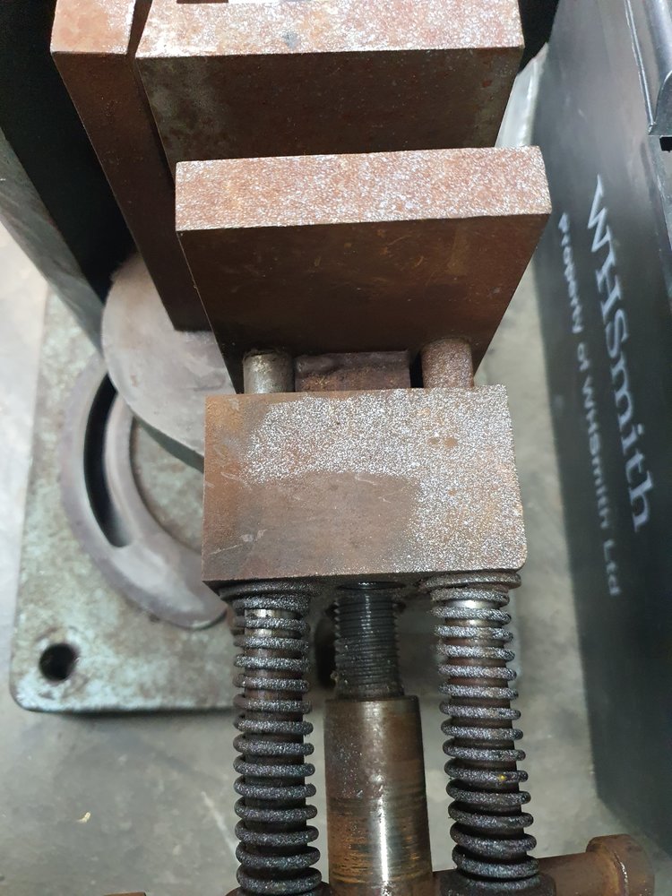

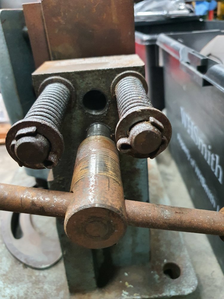

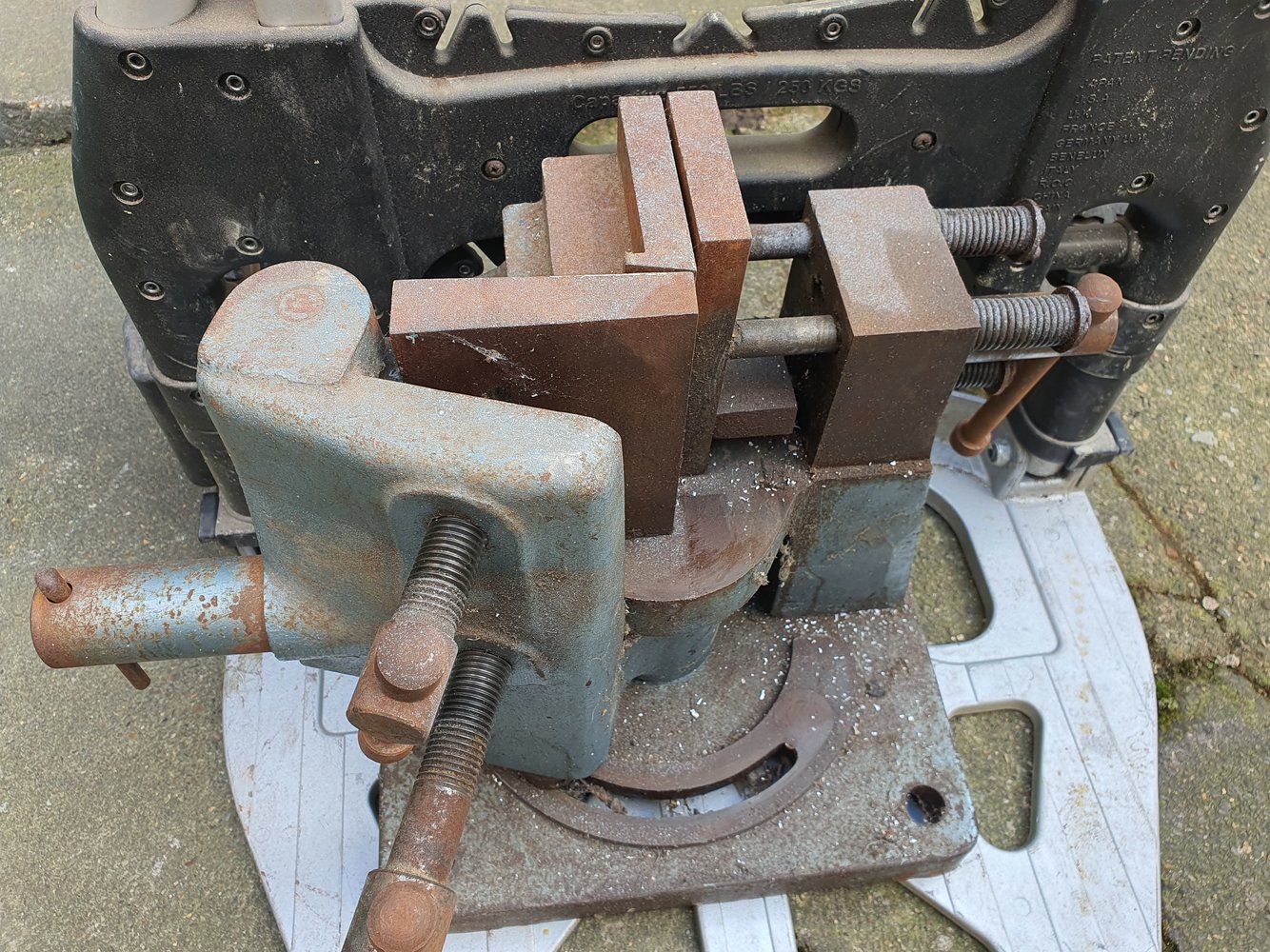

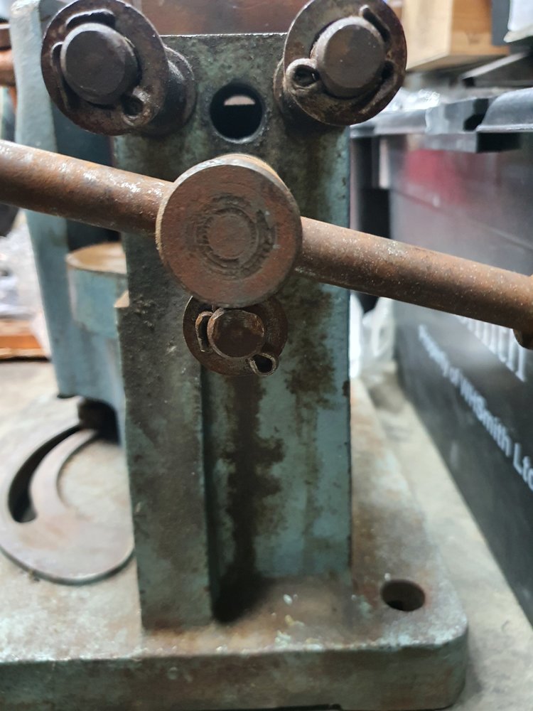

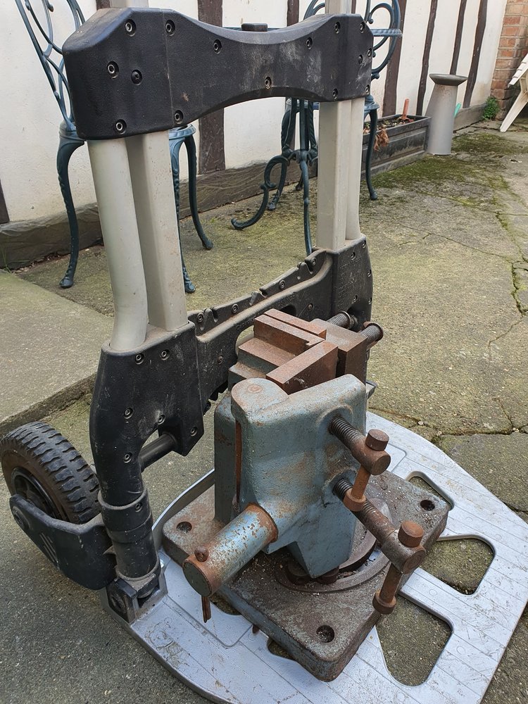

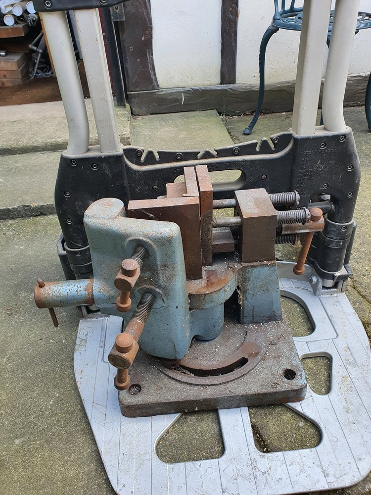

Piero Member Messages 1,400 Location Uk Feb 9, 2022 #1 Hi guys Looking for a little help/photos I've newly acquired this bender, It differs from other ones I've seen of the same make as in mine has two adjustable bolts per plate. The vice has to threads in it for accepting two adjustment bolts, but only one bold is present. Possibly it has lost one

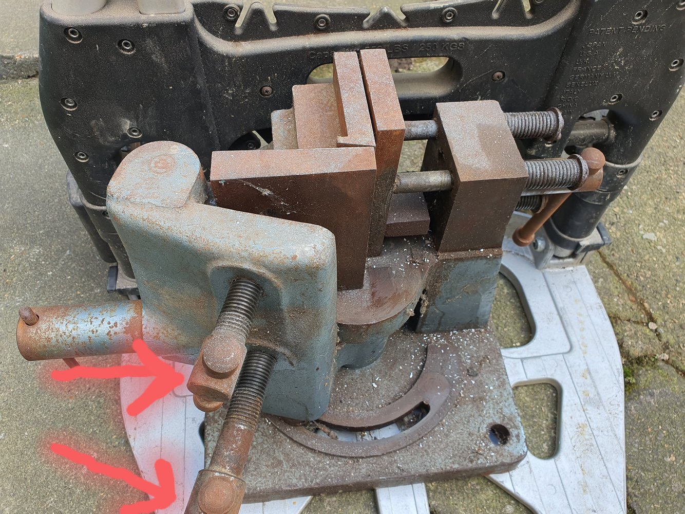

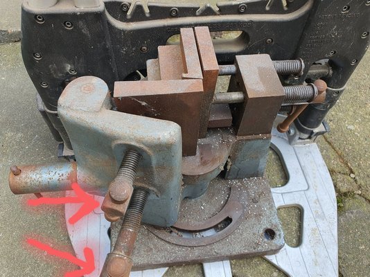

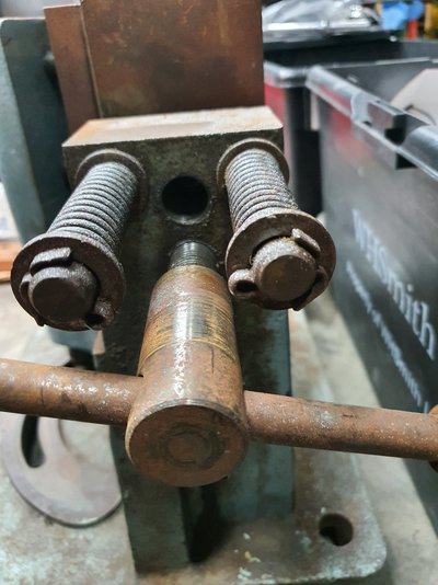

Piero Member Messages 1,400 Location Uk Feb 9, 2022 #2 Note two bolts The vice has only one fitted but there is a thread cut for two bolts It's simple enough to make one but I am also interested to learn more about this bender the the exact model I have acquired

Morrisman Forum Supporter Messages 8,813 Location Staffordshire, England Feb 9, 2022 #3 Well I’m seeing two bolts, no empty tapped holes, so am I missing something?
Piero Member Messages 1,400 Location Uk Feb 9, 2022 #4 Your looking at the adjuster plate Not the vice

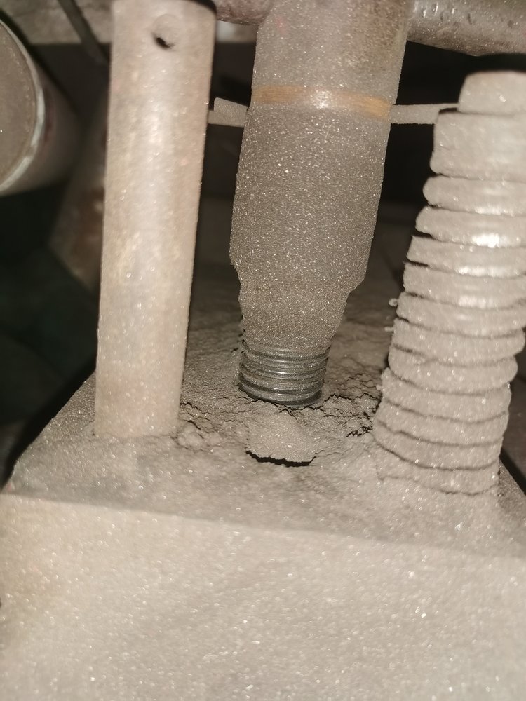

500e Always buy fire insurance a flood is a hard start Messages 9,161 Location South West Feb 9, 2022 #6 Friends bender nothing in it, no second spring either. But a lot of grinding dust
Morrisman Forum Supporter Messages 8,813 Location Staffordshire, England Feb 9, 2022 #7 Piero said: Your looking at the adjuster plate Not the vice Click to expand... The two big red arrows pointing at two screws were just a test then?

Hitch Moderator Staff member Messages 13,509 Location England Feb 9, 2022 #8 Keep the screw in the low hole for narrow stock/round... move it up for wider stock- so its nearer the middle of whatever youre bending.
Piero Member Messages 1,400 Location Uk Feb 9, 2022 #9 From what I've found out. Most are a number 2 bender Mine is a number 3
Piero Member Messages 1,400 Location Uk Feb 9, 2022 #10 Morrisman said: The two big red arrows pointing at two screws were just a test then? Click to expand... You probably did what I mostly do. Looked at the pics but didn't fully read the post. I did explain

Tigman Forum Supporter Messages 3,911 Location Watford UK Feb 9, 2022 #11 2 holes on vice to move and tighten to different size stock as mentioned , where's the handle ? Is it a large tube ?

500e Always buy fire insurance a flood is a hard start Messages 9,161 Location South West Feb 9, 2022 #12 Mates is about 5/6 ft thick wall Great tool for brackets though
