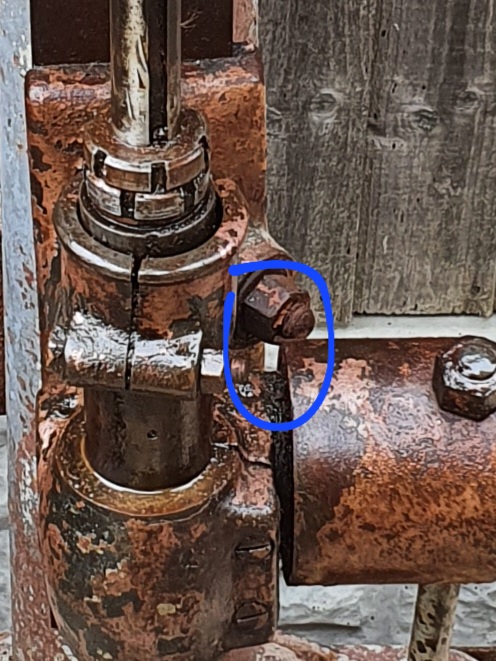

Munkul Jack of some trades, Master of none Messages 7,843 Location Cumbria Apr 28, 2022 #21 heat? impact gun?
M merryman Member Messages 814 Location Lancaster, England Apr 28, 2022 #22 If it is a stud and the stud is coming out, whatever it is holding will still loosen.
J Jonny weld Member Messages 87 Location Colchester Apr 28, 2022 #23 Munkul said: heat? impact gun? Click to expand... Will try to heat, no access with impact gun as you can see
Munkul Jack of some trades, Master of none Messages 7,843 Location Cumbria Apr 28, 2022 #24 plenty access if you take the handle mechanism off.
A Agroshield Member Messages 6,497 Apr 28, 2022 #25 If you want the nut to come off the stud, tighten it back up and wire brush the crud off the exposed threads. Try tightening it a little until it shifts relative to the stud and then add penetrant. You could saw a screwdriver slot in the end of the stud to stop it rotating.
