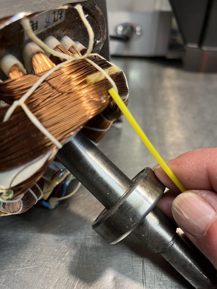

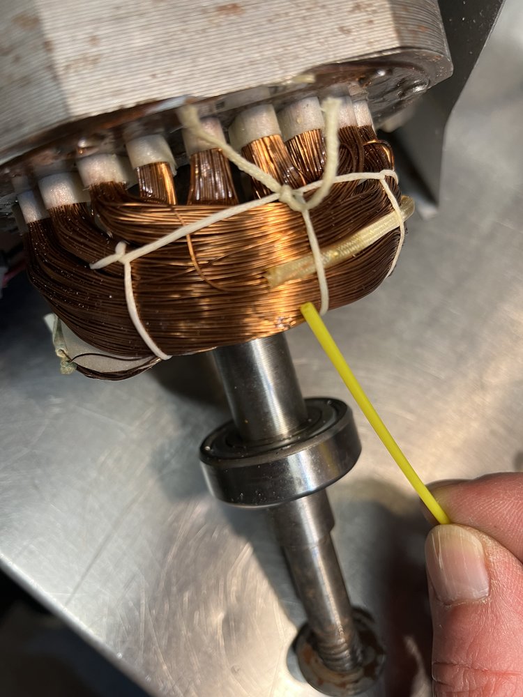

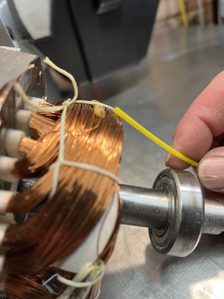

Recently got a wet/dry bench grinder 2nd hand in for sale section, which worked fine.
Switched on today and just hums, no mechanical jams on the wheels, turn fine by hand.

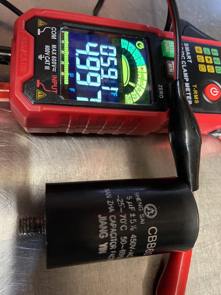

Got the start cap out and has a little 5mm case crack but does not looked swelled or leaking/poor. Although didn't get any spark when took out and arched to discharge.
Tested it and the uf looks pretty much spot on.
Any ideas?
Any ideas?
can't see any obvious damage but for a 2nd hand £40 grinder not worth going further. I will strip this one for parts / wheels etc and get another.
