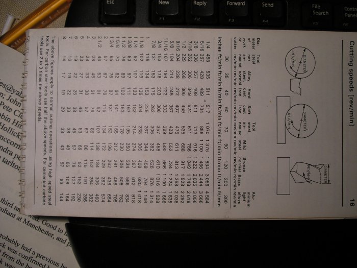

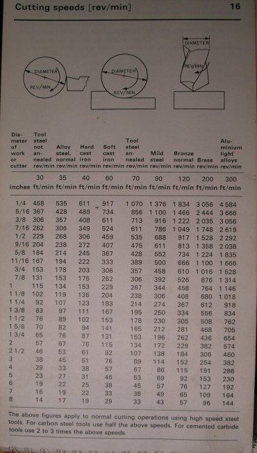

basically, bigger drill = slower speed/feed on steel
i.e. small pulley motor = large pulley drill shaft
best thing is to try it out,we all tend to think faster better at the start,then you lower the speed/feed and see the drills cut better/quicker than faster/red hot drill tip
