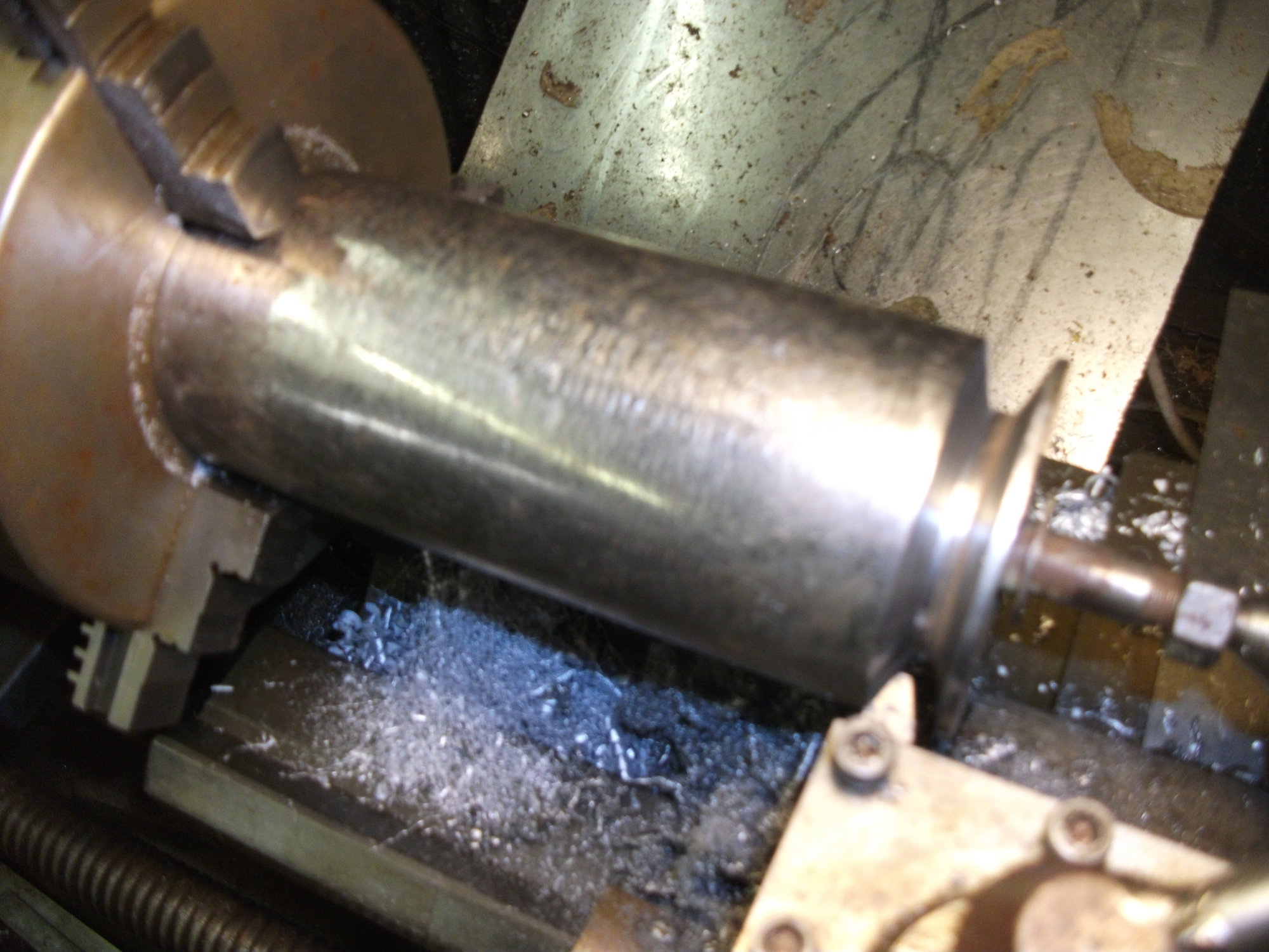

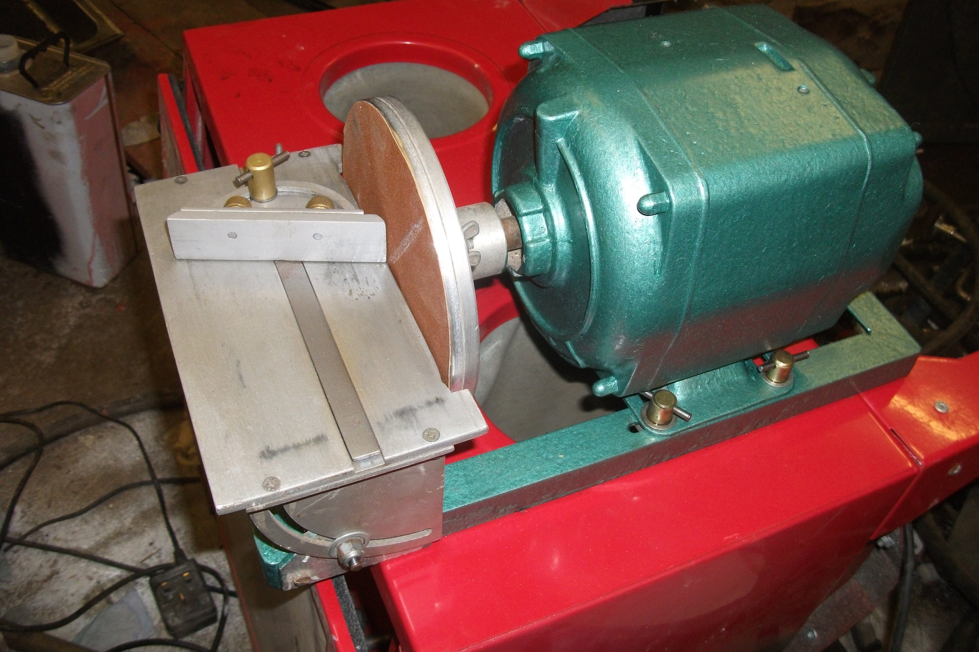

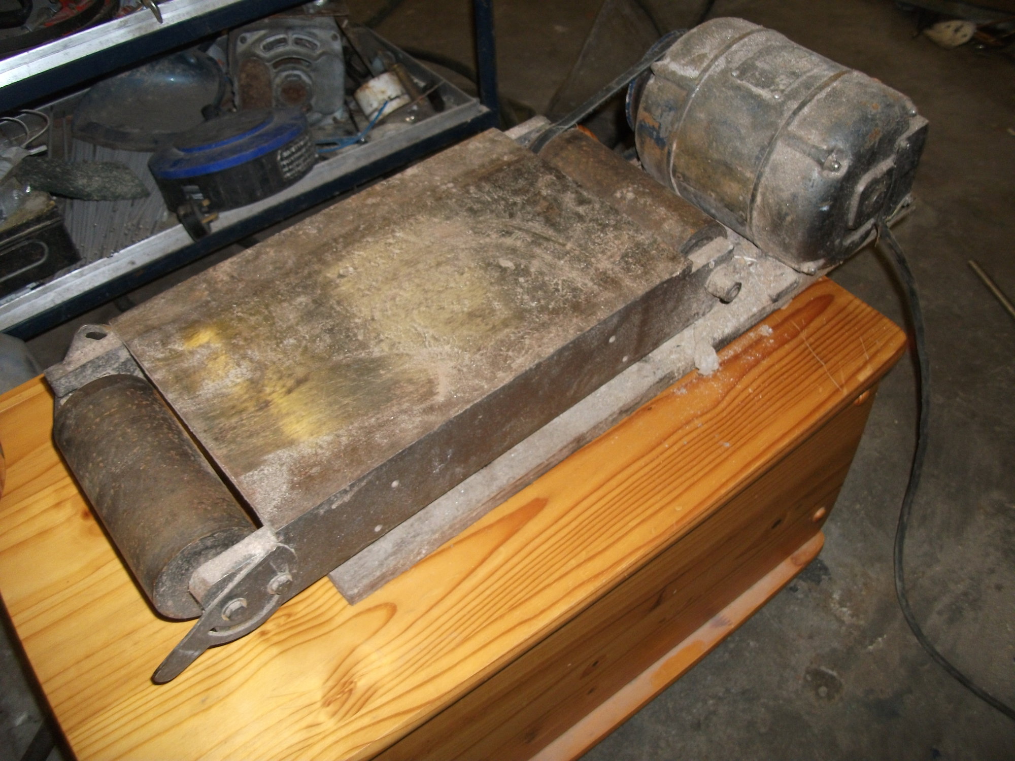

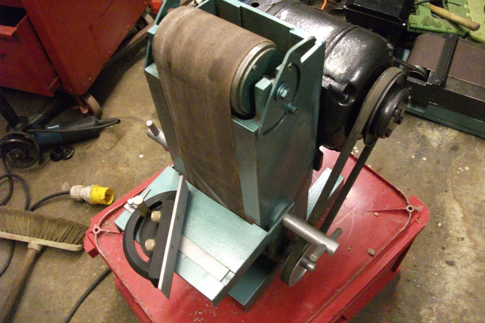

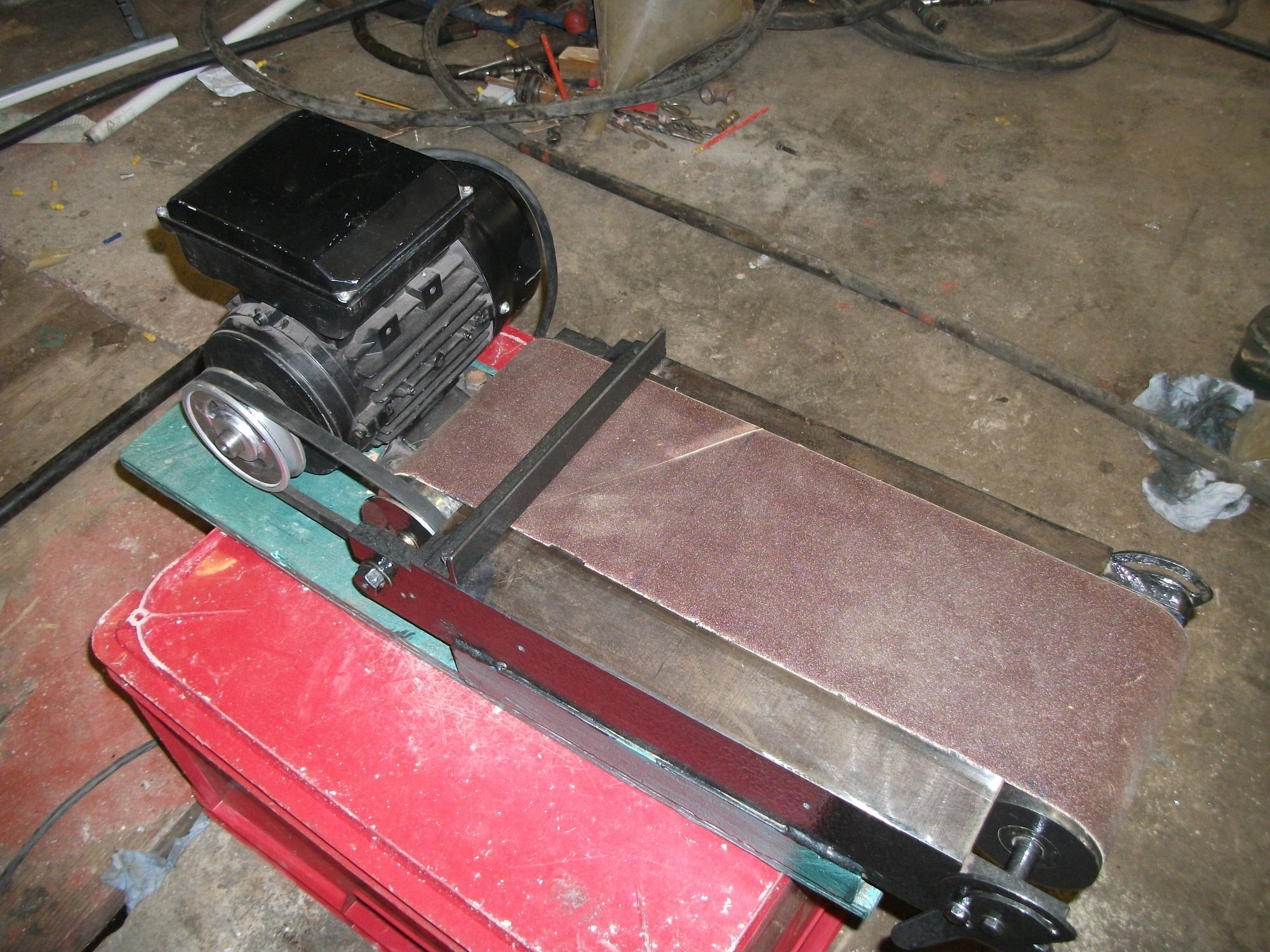

after 30 years use it was time to refurb the belt sander . it didn't need it but I wanted the half hp motor of it for my 4 inch sander that's only got a 1quarter hp motor fitted . I bought a 3/4HP motor of jonakay that fit the bill nicely . I got an a section pulley and a new belt but the v on the roller was smaller so set it up on lathe and opened the v out to the correct size. the pulley was a blank so bored that out to 19mm to suit new motor . set it up and a quick re paint job done . just got to fit motor on the other one now
