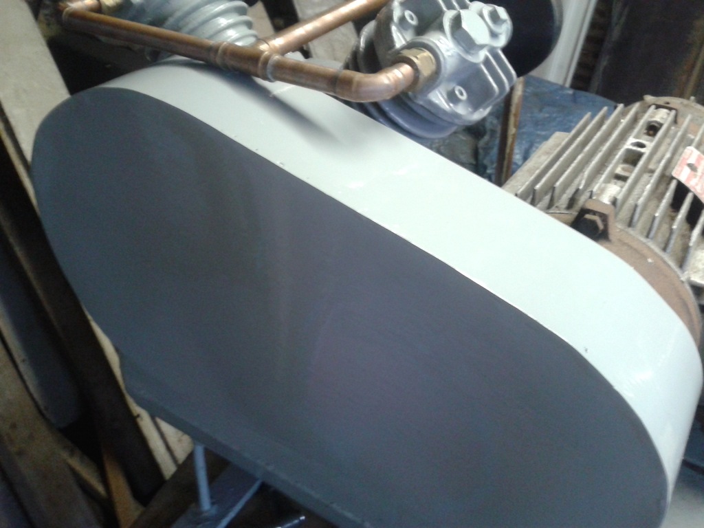

So, the compressor is sorted, but i want a guard on the belt.
Ive made up a pear shaped guard this morning, with an edge the whole way arround.
Basically this sort of thing -
It covers the pulleys fine. The thickness is 90mm.

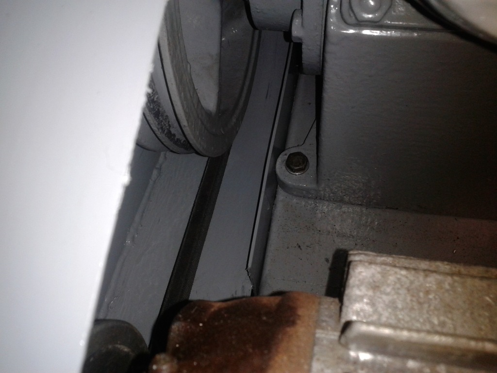

If you really tried, however, you could still get your fingers around the back. Not easy, but possible.
A lot of the images on google seem not to have a back, so is this risk considered acceptable? My dogs certainly couldnt get their snouts in there any more, which was my main concern.
the fly wheel acts as a fan for cooling the pump and draws cool air over it
