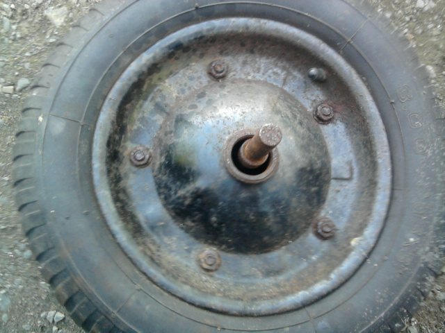

It's a wheelbarrow, you don't need to split the rim to get the tyre of just use levers but that's not what he was after. Again, it's a wheelbarrow, find a piece of tube that fills the gap and put plenty of grease round it you don't need a roller bearing.
