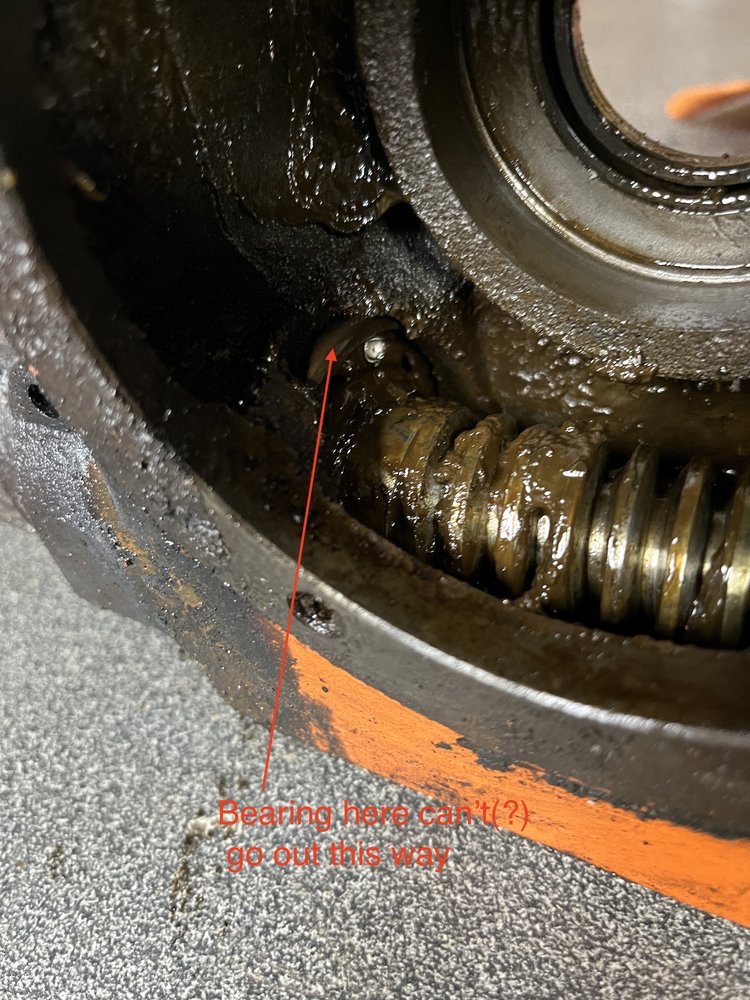

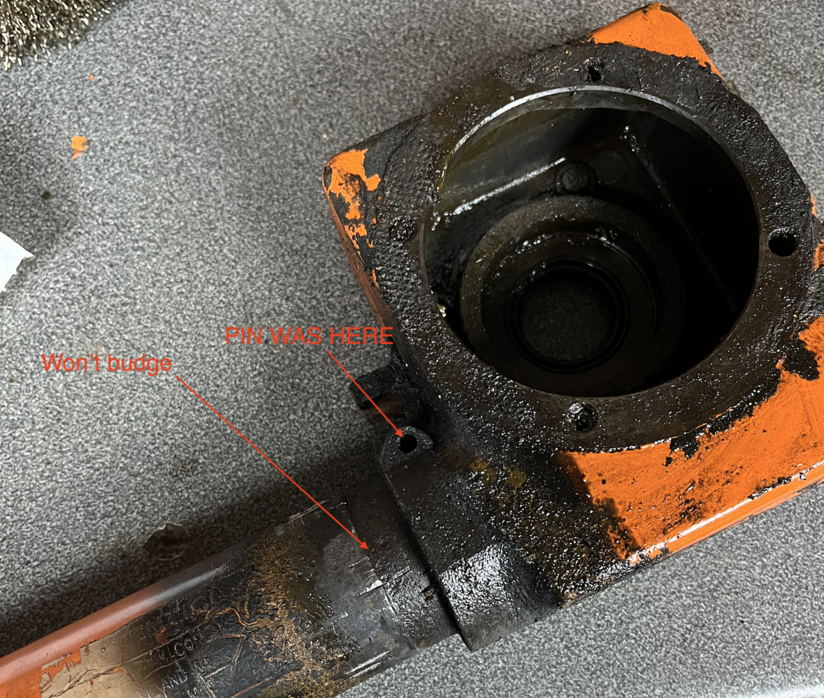

I've been given a belle maxi 140 cement mixer with some parts missing (top cover/bearing housing and pulley) but in a ok state. I'm taking over where the last owner stopped: dismantling the gearbox. Bearing are bad and the shaft may be bent.
I'm here:
I've removed a pin but the tube going out won't move (tried applying heat, rotating it with a pipe key). It seems that it has to come out this way because of the following bearing inside:
I know it can be done because of that post.
Can anyone point me in the right direction ? Couldn't find anything from google expect from the above mentionned post.
