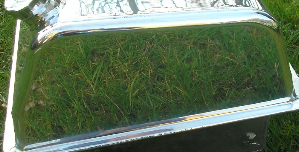

Cheers. The air intakes i let into the decklid were where wheeled and a wheel would be useful for many shapes of motorbike tanks too. Those car tanks not so much as it's all small radii curves and only on the edges of panels. They were done by tuck shrinking, some simple homemade wooden formers and really basic hand/panel beating tools for the most part except for a bead roller/jenny swage and a lathe to make the dies for pressing the relief to recess the fuel gauge sender
