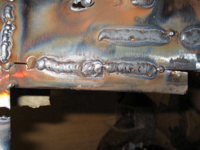

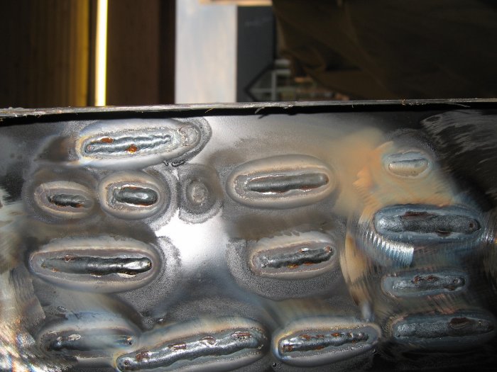

1st and 2nd pics. Front and back.
Just over 1mm sheet.
Power Setting 1 Power Switch Low seemed best.
I was experimenting with power and wire speed. I'm fairly happy that in the end I had good penetration. A lot depended on how fast I moved the head. I found that having a good rest mad all the difference. Work was nearly horizontal

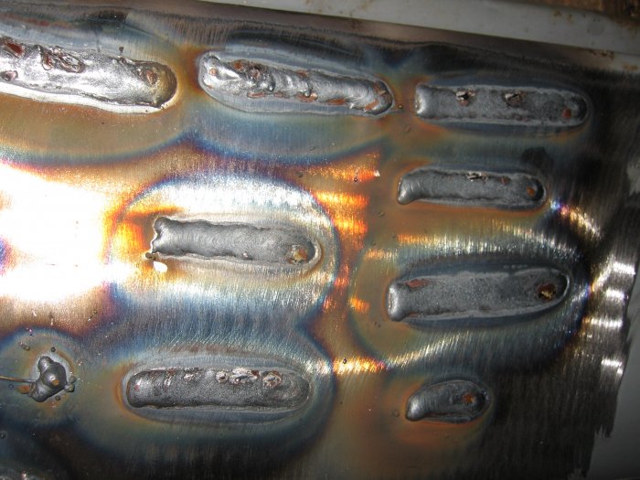

2nd and 3rd pics. Front a back
Just under 1mm sheet.
Same thickness metal but tried a crude butt weld, without being to careful. Work was about 30 degrees.

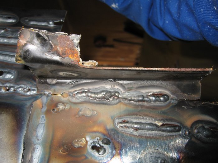

4th Picture. All the way through
Just under 1mm

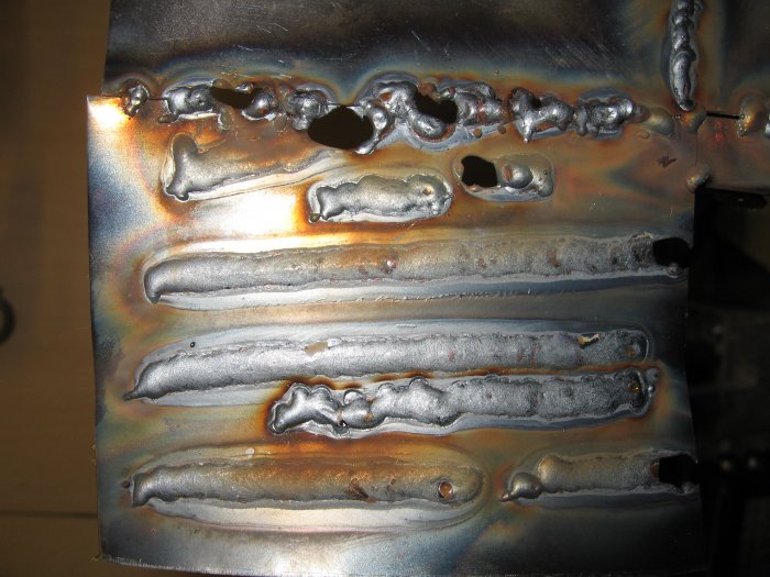

Had to happen, it was going too well, it all went wrong. Tried a butt weld vertically. I know I'm definitely trying to run before I can
walk
but I thought I'd have a go as so much of the work on my car is in situ so will be vertical.
I'll be practicing all of the above over the next few days, including different thicknesses and plug welds etc.
But in the mean time can anyone help me out with the vertical technique?
I didn't get the chance to try the pulse method as described in Malcolm's video, is that the kiddy?

. Unfortunately it is not but I would say your first welds look pretty good for a 10 minute welder. Certainly I will ne pleased to meet a similar standard off the bat.
